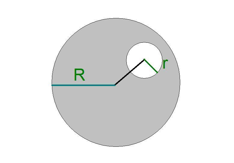

Here is one I've drawn. Sphere with radius R has a smaller hollow sphere inside with radius r (r<R). The distance between their centers is L, and the bigger sphere has uniform charge density rho. How is the E-field inside the hollow like?

The field everywhere is just the superposition of two field contributions: (1) the field from the solid sphere of charge of radius R; (2) the field from the sphere of opposite charge of radius r.
Use Gauss's law to find those field contributions. (You can't use Gauss's law directly on the original charge distribution since it lacks symmetry--but you can certainly use it for the spherical distributions.)
First, use Gauss's Law for the large sphere, and ignore the hole. Derive an expression for the electric field anywhere inside the sphere. Your result should be linear so that as r increases the field increases. Next, use Gauss's Law again for the small negative sphere (BTW I would pick a different letter for its radius, like a or something, so that you don't mix up r from Gauss's Law) and derive an expression for the field inside the negative sphere only. Then simply add your two results together, and evaluate for some spot inside the hole. The only tricky thing will be relating a, R, and L to the r for the spot you've chosen.

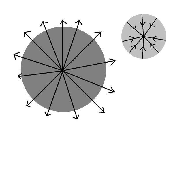

I've made another sketch, a rather similar one. The bigger dark gray sphere has uniform positive charge density rho, and so its E-field is nice and points radially outward. Now the smaller sphere has uniform charge density rho too, but negative now. Such that by putting it in, we effectively create a hollow sphere with no enclosed charge. Now if we do the same addition for the E-fields, by superposition; what I see is that there is only one radial component of the E-field, and that is the one which passes through both centers. The remaining E-field have to be added, and that is the part that causes confusion. Do correct me where I went off track. Thanks.
