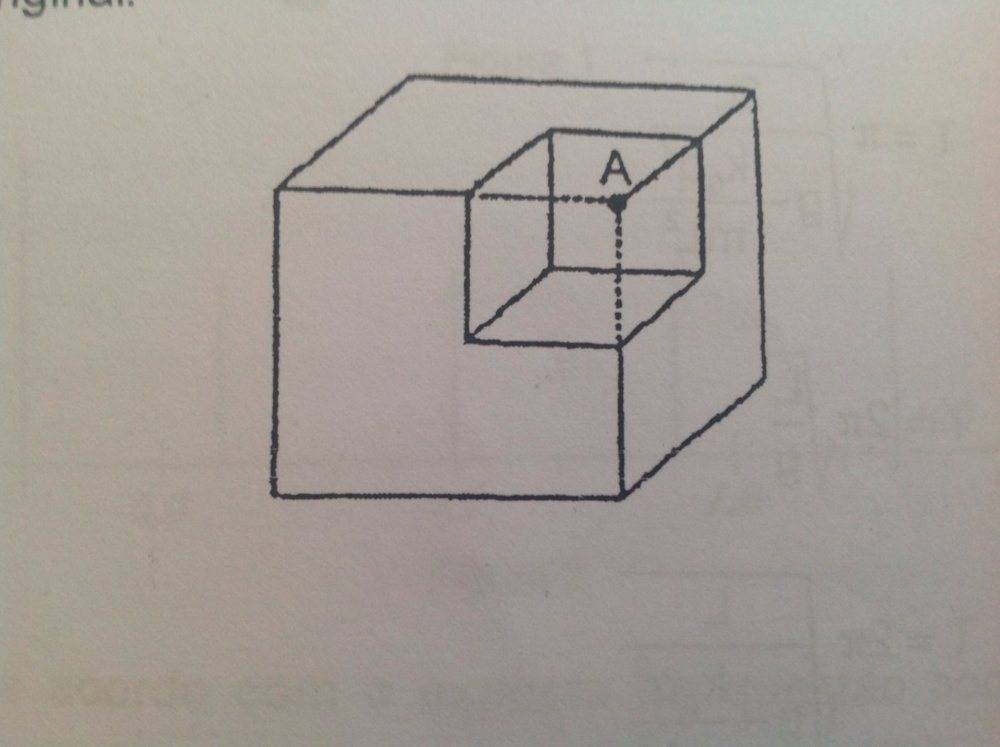

The electric field in point A due to the cube with side a and with uniform volumetric charge density is E. What is the electric field at point A when a cube of side a/2 is taken out from the original cube, such as in the picture.
E=kq/r^2
Tried to use gauss law but there isn't any usefull symmetry that I have seen. Also tried to integrate the field due to small charges over the whole cube, didn't work too since the integral were too much complicated.

Given that the electric field in point A due to the cube with side a and with uniform volumetric charge density is E, would you know the field at point A due to a cube with sides a/2 with the same, but opposite sign charge density ?
I have no other relevant equation that could be used and as I sad, the integral of the electric field due to charges dq is very difficult since you need to do it using the components in Cartesian or polar coordinates, the angle and distances vary making the integral very difficult. I think I need to use some superposition principle as you mantioned by calculating the electric field of the cube with opposite charge density and side a/2. I just can't find a relation between the electric field and the dimensions of the cube

I also agree with your conclusion: we need to find a relationship. Can we use some kind of similarity argument ? Suppose it's not a cube but a sphere with radius a: what happens to E at the surface when we reduce the radius to a/2 ?
The field Will reduze by a factor of 2 using the field of a uniformly charged sphere which can be considered a point charge for calculating the field, then just use volume of sphere and that the density remains constant. But can't see how this helps, since not necessarily the field in the vertice is of the form E=kl , where k is constant and l some mesure of the cube which can be its side.

Correct. Charge reduces by factor of 8, 1/r2 increases by factor of 4. No use is made of the shape of the charge distribution, so the same argument holds for a cube.
If that isn't plausible enough: let's return to the integral (which we don't have to calculate: that's already been done and the result is the given E). But we do look at how it changes when the cube shrinks to half size:
Given $$ E = k \rho \int_0^a \!\! \! \int_0^a\!\! \! \int_0^a {1\over x^2 + y^2 + z^2}\; \mathrm{d}x\; \mathrm{d}y\; \mathrm{d}z $$ we want to know $$k \rho \int_0^{a/2}\!\! \! \int_0^{a/2} \!\! \! \int_0^{a/2} {1\over x^2 + y^2 + z^2}\; \mathrm{d}x \;\mathrm{d}y \;\mathrm{d}z$$
See a factor 1/2 coming up ?
hint: change of variables ##x\rightarrow x'/2## etc.

Now I see, very nice to work with the integral without really getting to some explicit function, got the ideas

For the record, here is the argument based on finitely many point charges.
If ##E## is the strength of the field at point A due to a small cube, then imagine moving every charge twice the distance to form a larger cube. The field of this larger cube is ##E' = E/4##.
But, the larger cube has a charge density of an 8th of the smaller cube. If we increase this to give a new large cube with the same density, then the field of this cube is ##E'' = 2E##.
