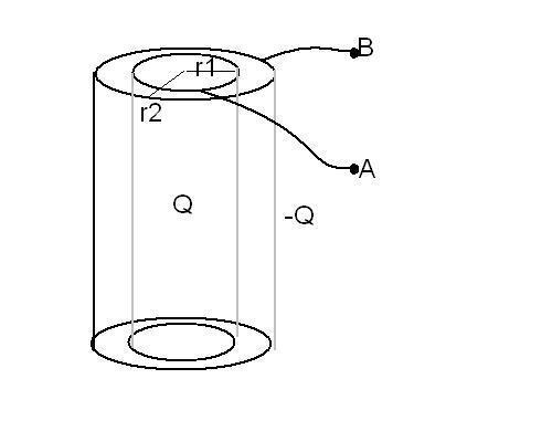

consider a cylinder capacitor of length 1m , inner radius 0.1cm and outter radius 0.2cm. You connect the capacitor to a 10V battery. What is the electric field strength at the inner radius?
a) 0v/m
b)infinity
c)7.7 kv/m
d)14.4kV/m
C= k*L/ln(b/a)
q=C*V
E=V/d
E=k*q/R^2
first capacitance of a cylindrical capacitor is known to be
C=K*L/ln(b/a) (b=0.5/a=0.1)
then i thought to calculte the charge q=C.V
but i can't see the relation to find the electric field E :S
and also the thing about the inner radium made me confused..
You see a cylindrical capacitor in the figure. Try to use Gauss' Law to get the electric field at the inner radius r=0.1 cm.

will it be =0?? cause in the inner radius no charges?
this is gauss law : E=q/epsilom0*A :S
i tried the calculation no answer fits mine.. so i thought it might be 0 because it is in the inner radius?
Sorry if it seems that i am so narrow minded.. i have been studying physics since this morning,got look of chapters and exams coming this week..
Thanks again! i really appreciated your help
i think i have found it! :D
narrow minded me.. tonight.. because tired.. mixing the formulas..
the true formula is :
C= 2pii*eps0*L/ln(b/a)
then q=c*v
and then E=q/eps0*A(gauss law)!
and i got the last choice 14.4kV/m!
Just one more thing.. can anyone track me if it is correct?? you gave me this procedure,did i used it in the right way?
Evening! and thanks a lot!
It is correct. :smile:
