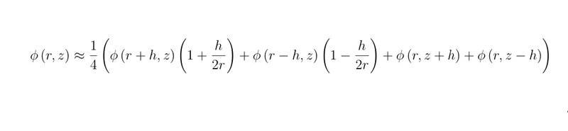

there are two finite disc distance d from each other in the z axis potential difference between them V_zero find capacitance q and electric field between them
relaxation method , Q/C=V
I did make the problem simpler by looking at the the part from d/2 down the upper plate
here are my initial parameters I am making my size step be h since lowering it may make calculating harder
I am especially getting weird results for the field and capacitance

kirito said:
phi(i+1, j) * (1 + h / (2 * i))
I am not seeing the logic behind this expression. Please explain it.
E.g., i is a dimensionless number but h has units of metres, so 1 + h / (2 * i) is dimensionally inconsistent.

you are correct I have preciously defined r=hi so if I have r_2=2h r_3=3h and so on then I said I will substitute it instead and forgot to delete the h from the upper term making it into 1+ 1/(2)

This still looks wrong to me:
kirito said:
old_phi(i+1, j) * (1 + 1 / (2 * i)) + ... old_phi(i-1, j) * (1 - 1 / (2 * i)) + ... old_phi(i, j+1) + old_phi(i, j-1)
Why the 2*?
You seem to have fixed 0 potential at r=0 and r=rmax. Wouldn’t it be better to have it as linearly Vmin to Vmax at r=0, and maybe also at rmax?
Also, you set V0/2 at one plate, so shouldn’t you set -V0/2 at the other?

the 2* because i was asked to take r as ih which is the step taken in the r direction
Why did not i set the potential on the other plate to -vo/2 because i only looked at the upper plate taking it only into account

For a given circle (r value and z value) you have four adjacent circles: (r+h,z), (r-h,z), (r,z-h), (r,z+h).
The contributions of these to the potential at (r,z) at the next time step must be weighted according their "volumes": r+h, r-h, r, r. Normalising, 1+h/r, 1-h/r, 1, 1. But you have 1+h/(2r) etc.
Yes, sorry, I forgot you were modelling only the upper half.
But what about the potentials at r=0 and r=rmax? It is not right for those to be fixed at 0.

The reason for the two because the formula i got when using symmetrical first derivative to approximate Laplace in spherical coordinates was this

For r=0 i thought its the condition so potential at z=0 is zero
For rmax i though i should take it as 0 since at infinite distance we consider potential zero

Better would be to set each potential at r=0 at t+1 from the potential at r=h, same z, at time t.
if you don't mind further explaining what this means , not sure if I get it , to set the potential at t+1 from r=h is bit unclear to me
At each time step you set the potential at each (r,z) coordinate from its neighbours' potentials at the previous time step, but not for r=0. I'm saying set it at (0,z) from the value at (h,z) at the previous time step.
Or you could do an average involving (0,z+1), (0,z-1) too, but I don't think that changes much.
your explanation is much appreciated, thank you
