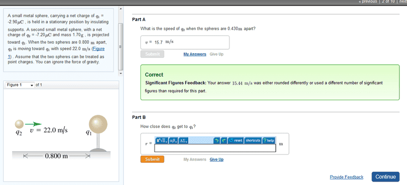

A small metal sphere, carrying a net charge of q1 = -2.90 μC , is held in a stationary position by insulating supports. A second small metal sphere, with a net charge of q2 = -7.20 μC and mass 1.70g , is projected toward q1. When the two spheres are 0.800 m apart, q2 is moving toward q1 with speed 22.0 m/s as in figure 1. Assume that the two spheres can be treated as point charges. You can ignore the force of gravity.
I have attached an image of the question
1/2mv^2 = kinetic energy
u = kq1q2/r
As my attached image shows, I have gotten the correct answer fort his question but I'm not sure how I did it.
So I began by calculating the electric potential energy (U) when q2 was 0.43m away from q1.
U0.43m = k(-2.90x10^-6 C)(-7.2x10^-6 C)/(0.43m)
U0.43m = 0.437 J

I then calculated the electric potential energy (U) when q2 is 0.8 m from q1:
U0.8m = k(-2.90x10^-6 C)(-7.20x10^-6 C)/(0.800m)
U0.8m = -.2349 J
I then subtracted U0.800m from U0.43m
= 0.437 J - 0.2349J
= 0.2026 J
I then plugged this ΔU into the kinetic energy formula
1/2mv^2 = 0.2026J
v = 15.7 m/s
Why was it necessary to find the electric potential energy of the two distances?

This is because the total energy is conserved. PE + KE = constant. So if the system has PE1 at some point, and PE2 at some other point, then PE1 + KE1 = PE2 + KE2, hence PE1 - PE2 = KE2 - KE1.
