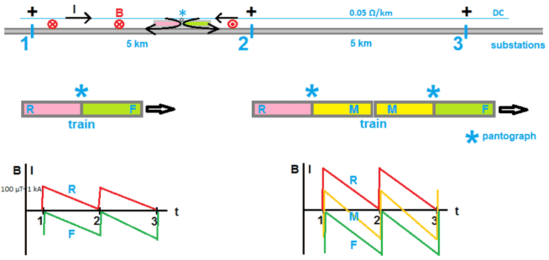

As a passenger of the train, you might use a smartphone to monitor the magnetic field produced by the current in the overhead line. The magnetic field is proportional to the current. If the B-x diagram is linear between two substations, the losses are small. If, however, there is a big dip halfway between the substations, the losses are serious.
But that happens mostly only with third rail electrification not with the overhead wire , in my country i can't remember when was the last time someone got electrocuted because we only have overhead wires.

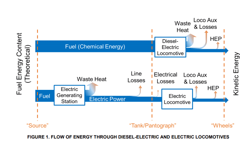

An interesting paper here
https://railtec.illinois.edu/wp/wp-content/uploads/2019/01/JRC2014-3787.pdf
compares electric and diesel on a "Well to Rail" basis by accounting for where the waste heat is produced
and converting kwh into equivalent gallons of diesel fuel..
They compare two commuter systems,one electric in SE Pennsylvania and one mostly diesel near Chicago.
and conclude the energy efficiency isn't much different at all when comparing car-miles per unit of energy
what makes the difference is how long you make the trains and how full you fill them.
To OP's thread title
same paper states
Thermal efficiency of electric locomotives, when measured from the pantograph (or power meter) to the work performed by the wheels at the rails, is approximately 76-85%.

Good stuff Jim. But here's a couple of comments
  • Waste heat for the power plant depends on the type of plant, steam/hydro/solar PV all have radically different numbers.
  • Note that those comparisons do not mention resistive losses in the power transmission. That suggests that those losses are negligible. This whole thread centers on the OPs estimates of resistive losses.

In the chart with the curved arrows, isn't that the little one just to the right of the dotted line?
Yes. But in the two plots of MPG versus year, there is no mention of transmission losses.
Of course actual losses depend on where the power is generated. In SE PA, some power plants are local, some power comes from Hudson's Bay in Canada. Averaged nationwide, T&D resistive losses are 5.9% (https://data.worldbank.org/indicator/EG.ELC.LOSS.ZS) But it is likely that the study Jim cited assumes locally generated power, so they didn't bother to calculate actual losses.
