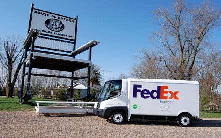

FPL and Duke Power are replacing their entire car and truck fleet (10,000) with EV's starting next year.
http://online.wsj.com/article/BT-CO-20090924-705557.html" .
This makes since 1) they don't need long distance, 2) on a cost per mile basis the EVs are at least break even today, and can only become more cost effective in the future.
There seem to be a dozen or so bucket truck vendors, who all buy their chassis from either GM, Ford, or International. I'll be curious to see which one steps up w/ an EV chassis and one of them will, as they're not going to give a foreign make an entry into the truck market.
