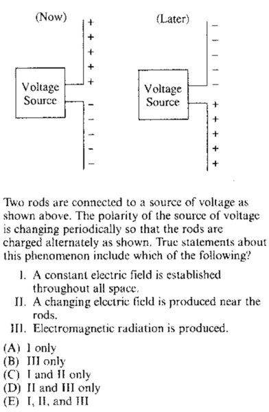

In addition to the question given in the attached file below, I don’t understand how is the polarity changing periodically.
Concept-based question, I guess.
I have no idea how should I approach the question. So, if anyone has an idea, can he/she explain?

A generator producing Alternating Current (AC) would be an example of such a voltage source. First one side is at higher voltage, then the other, and they switch back and forth in a sinusoidal pattern.
The question is asking you what the effect is of the charge distribution changing back and forth between those two pictures periodically. What have you learned about changing charge distributions?

As mentioned by @RPinPA a signal generator can make such a changing output voltage. The voltage between the two rods could vary with a sinusoidal function like:
V(t) = 1V * sin (2π * 1kHz * t), and you could alter the amplitude from 1V and the frequency from 1kHz if you want a different driven waveform.

For each of the 2 figures, draw the E field lines from + to - charges, just as you do for other geometries with charge separation. If you need help with that, try Google Images with appropriate search terms to get some ideas. With those two modified diagrams, you can partially answer the question.
To fully answer the question, search on "dipole antenna operation" or similar. Let us know what you find... :smile:

Ahh, apparently I didn’t learn something about this topic. So, I need to know changing charge distribution and AC.

But I do know how to draw electric fields. I am going to search more about the others ,and then come back to the question.
I have looked for dipole antenna and found that its like the ‘"rabbit ears" television antenna found on broadcast television sets’. There's a changing electric field throughout all the space because of the alternation and a changing electric field near the end of the rods. If the length is half a wavelength the will be radiation. So, I think the answer is D. Is my reasoning correct?
Yes, good work! :smile:
