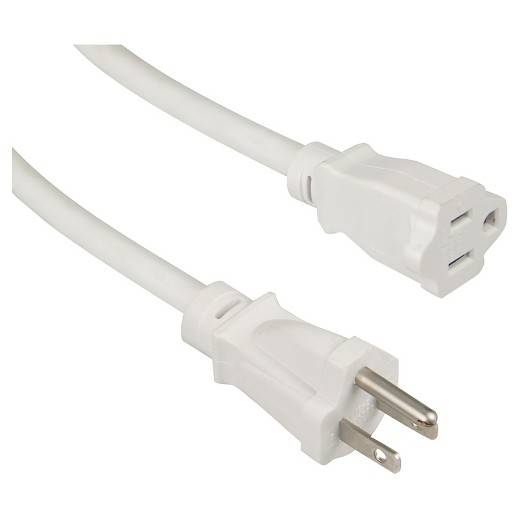

It's not really clear what fell in the bath.
If it was a cable carrying AC mains to some other device, the result is unsurprising.
They talk about an extension cord from the hallway ...
PC Craig Pattison told the inquest at West London Coroner's Court how he found the extension lead running from the hallway outside into the bathroom.
"We found an iPhone plugged into the extension cable and then the charger element in the bath," he explained.
The phrase "charger element in the bath" leads me to believe that the AC cord and charger itself fell into the bath, not just the phone and charger cable end. The hallway probably would not have had a GFCI (at least not in the US - those are more commonly used in the bathroom and kitchens or any wet area, but older homes may not have them).

US code says there should NOT be a receptacle within reach of the tub, for obvious reasons.
That suggests he had it plugged into an extension cord,
and if that fell into the tub anything could happen.
That said, low voltage will really shock when your your skin is wet. I state from personal experience it is impossible to hand tighten a loose 12 volt boat battery terminal when you're soaked with seawater . It would not surprise me if somebody immersed chest deep in water maybe laced with bath salts were to get electrocuted by fifteen volts.
My bet though is on the extension cord scenario, he got the high side of his power supply in the water.

If he had the trailing socket on his chest, charger plugged in, then a) that is catastrophically stupid, and b) I don't get the talk of sending Apple a letter about safety, nor the comments about there 'only being a transformer between you and the mains'. He got a shock from the trailing socket. No transformer or Apple product involved.

He dropped the extension lead (mains Voltage) into the bath. The fact that he was charging a phone is immaterial.
From Willem 's Sun link:
He suffered severe burns on this chest, arm and hand when part of it touched the water.
Wife Tanya found him when she returned home and first thought he had been attacked because his injuries were so bad.
5 volts at an amp from low voltage side of the charger won't do that . .
