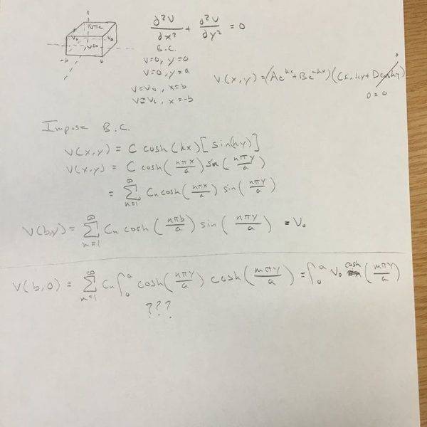

Two infinitely grounded metal plates at y=0 and y=a are connected at x=b and x=-b by metal strips maintained at a constant potential V. Find the potential inside the rectangular pipe.
Laplaces Equation
I posted a photo of what I've done so far. The line indicates where I stray off I'm confused because how can I use fouriers trick with cosh?
