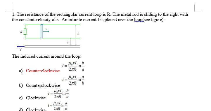

1. The resistance of the rectangular current loop is R. The metal rod is sliding to the right with the constant velocity of v. An infinite current I is placed near the loop(see figure). (please see word file attached)
The induced current around the loop:
answer is Counterclockwise , i=(μ0 vI×ln(b ∕ a))/2πR

1.
|ε|=dΦ/dt
B=μ0I×cos(0-cos180)/4πr
=μ0I/2πr
dΦ=BdS=μ0I×(vdtxdr)/2πr
ΔΦ=(μ0I×(vdt)/2π)x∫dr/r=(μ0I×(vdt)/2π)xln(b/a)
*the intergral goes from a to b
|ε|=dΦ/dt=(μ0I×v×ln(b/a)/2π)
i=ε/R=(μ0I×v×ln(b/a)/2πR)

1. is OK. For 2 (or is it 3?) look up the expression for the self-inductance ##L## of a solenoid and use ##V_L=-L\frac{dI}{dt}##, it's that simple.
On edit: Your derivation went astray at the "wait what?" Note that ##\dfrac{d \phi}{dt}=\dfrac{d \phi}{dI}\dfrac{d I}{dt}##. Now ##\dfrac{d \phi}{dI}## is a constant that depends only on the geometry since ##B## is always proportional to ##I## according to Biot-Savart. This constant is the self inductance ##L## which you can derive separately for your geometry.

Alright so for the first one, and I'm going to write all of this in steps so you could track it more easily;
Step 1: establish that |ε|=dΦ/dt and i=ε/R which means we only need to define ε.
|ε| is emf
Φ is magnetic flux which is equal to BdS
Step 2: Find B; which is given by B=μ0I×cos(0-cos180)/4πr which is simplified to μ0I/2πr
Step 3: Which means
dΦ= BdS = μ0I×(vdtxdr)/2πr
(vdtxdr) is supposed to be the area dS but I don't get why there is dr...vdt is totally fine.

For step 1 I don't see why you change over from ##\varepsilon## to ##|\varepsilon|## ?
That way, with ##\varepsilon = -{d\Phi\over dt}## you lose the sign
In Step 2 you implicitly choose coordinates (or do you mean scalar multiplication with your ##\times## sign ? And then determine the direction of ##\vec B## separately ? How ?
It is better to choose a (right handed) coordinate system first and then use Biot-Savart to determine the direction of ##B##. You don't have to carry out the integration, that's been done already and gets ##\mu_0\over 2\pi r##. Either that, or you use Ampere and somehow know the direction of ##\vec B##. Result: With ##\vec I## to the left, ##\vec B## is into the paper.
Next substep (still in 2) is the inner product $$\vec d\Phi = \vec B \cdot \vec {dS} .$$
Vector $$\vec {dS} = {\bf i} dx \times {\bf j} dy = {\bf i} \times {\bf j} (v\;dt \, dy) = {\bf k} (v\;dt \, dy) $$
So that [edit:] corrected in #10 $$\vec d\Phi = \vec B \cdot \vec {dS} = - {\mu_0\over 2\pi }y \;{\bf k} \cdot {\bf k} (v\;dt \, dy) = - {\mu_0\over 2\pi y} (v\;dt \, dy) $$ and if ##{d\Phi} = a\, dt## then ##{d\Phi\over dt} = a##, which leaves you with an expression in ##dy##, ##y## is running from a to b.

But what I NEED to understand is why is there dr or dy in the first place; it's a bar and it moves in a swiping motion left to right, it's length doesn't change so why is there dr or dy??
Kudos for picking out the most important issue here: in this exercise ##\Phi = \int \vec B \cdot \vec {dS}## changes with time, not because of ##\vec B## but because of ##\vec S## increasing with time. Write ##\vec {dS} = \vec {dx} \times \vec{dy}## and there you are.
