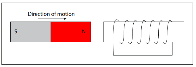

Problem:
Look at the following diagram:
Diagram of a bar magnet with left half grey labelled S and right half red labelled N, moving right with arrow labelled Direction of motion, beside a coil of wire wound around a rectangular core.
· Copy the diagram and then label the poles for the induced magnetic field and the direction of the induced current
· Explain what would happen to the magnetic field and the current if the direction of motion of the magnet is reversed
· Explain what would happen to the magnetic field and the current if the magnet was moved more quickly in the same direction
· Explain what would happen to the magnetic field and the current if the magnet is moved rapidly back and forth

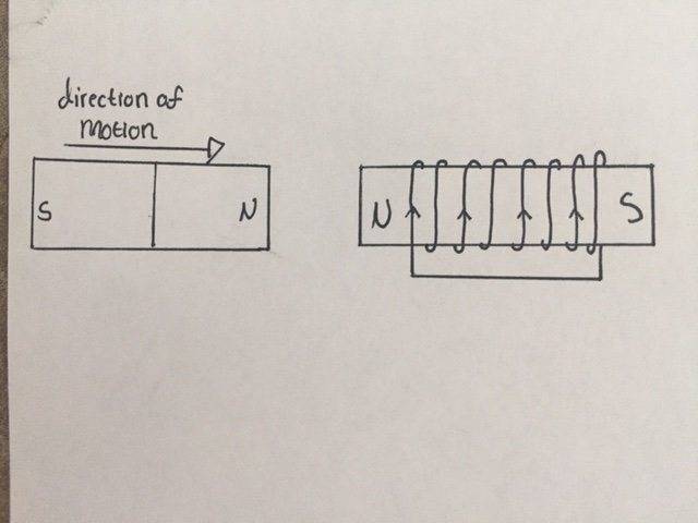

Attempt at answer:
1.
Hand-drawn diagram: left, a bar magnet with S on the left and N on the right, with an arrow above labelled direction of motion pointing right; right, the same magnet with N on the left and S on the right, inside a coil of wire with arrows showing winding direction.
2. If the direction of the motion of the magnet were to be reversed, then the magnet would be pulling away from the coil. As the coil will resist the change, the coil’s magnetic field would be changed so that its south pole is closest to the magnet. This will work against the magnet’s efforts to move away from the coil as opposites attract, and as the poles were reversed, the direction of direction of the induced current would also be reversed.
3. I'm not sure to which direction this implies... I know that if the magnet is moved forwards more quickly the induced charge will be greater. I am not sure if its the same moving backwards, as induced charges become weaker the further away the magnet is. Help!
4.If the magnet were to be moved rapidly back and forth, then an alternating current is produced. Moving the magnet in will induce a current moving one way, but moving it out will induce a current moving in the opposite direction. As this is repeated, current direction is constantly alternating, and an alternating current is then created.

Indeed, please refer to Faraday's Law and Lenz's Law when handling EMI questions :) Feel free to clarify on this thread if you have any doubts.
