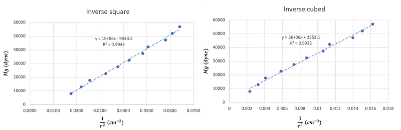

The analysis shown in the video is flawed primarily because it fails to convince the reader that the dependence of the repulsive force on pole separation follows an inverse square law. The presenter's conclusion that it does is based on the observation that when the force is plotted against ##1/(r_{\text{eff.}})^2## one gets a straight line. It ain't necessarily so.
I copied the data from the video and made two plots: (a) Force vs ##1/(r_{\text{eff.}})^2## (same as the video), shown below left and (b) Force vs ##1/(r_{\text{eff}})^3##, shown below right. Variable ##r_{\text{eff.}}## is the distance provided in the video. I fitted straight lines to both. The fitting parameters and R-squared (goodness of fit) are included. It is clear that the straight line fits are equally good and that one cannot tell from these straight lines which power law is the case.
It is also disturbing that the slope and intercept of the straight line fit are ignored. Usually, when one produces a linearized fit the slope and intercept carry useful information. So how can we figure out the power law?

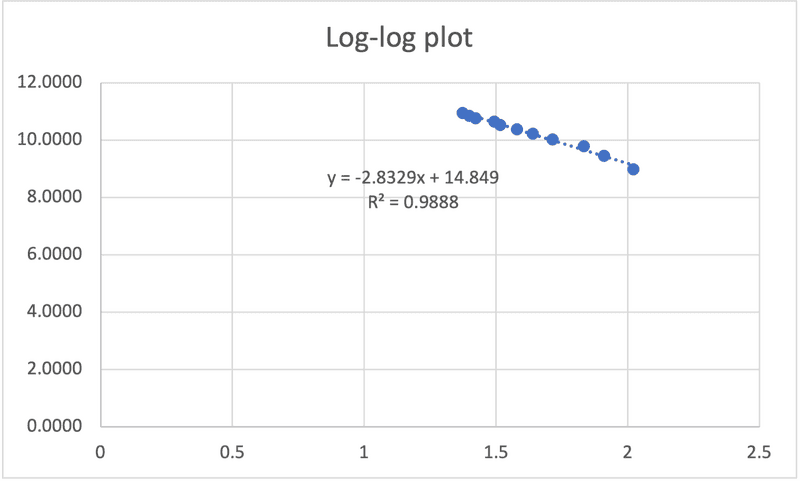

Note that if we assume a power law of the form ##F=Cr^n## and take the logarithm on both sides, we get $$\ln(F)=\ln C+n\ln(r)$$ Then we make a log-log plot which should be a straight line in which the intercept is the multiplicative constant C and the slope is the power to which ##r## is to be raised. This plot is shown on the right.

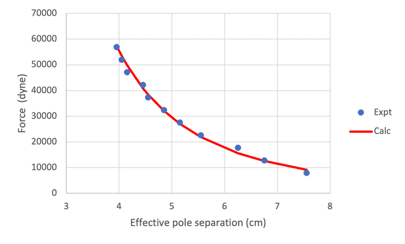

Now we can write the dependence of the force on pole separation as $$F=\frac{e^{14.85}}{r^{2.833}}$$ and plot the data on the same graph as the calculated values from the above equation (see right). The same result can be obtained by fitting a power law on a spreadsheet.

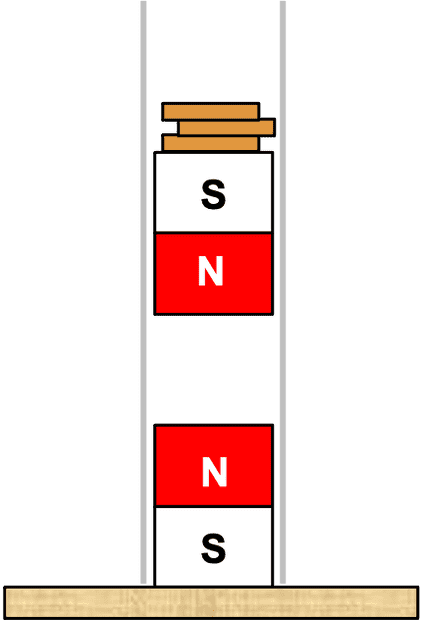

A very simple approach, if I may make a suggestion, is to place two cylindrical magnets in repulsion inside a transparent plastic tube of slightly larger diameter than the magnets (see figure on the right). Measure their initial separation then add non-magnetic weights such as copper pennies on the top magnet and measure the distance between the magnets after each addition. The force between the magnets is the weight of the top magnet plus the added weights. Easy to explain and analyze, only one moving part, no fuss - no muss.
Clearly, you need to pay some attention to the accuracy of measuring the magnet-to-magnet separation. For starters, I would tape a 12-inch flexible plastic ruler on the containment tube and refine from there.
