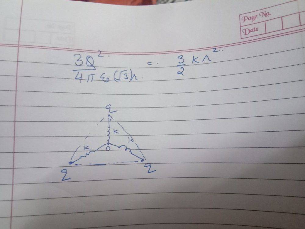

If you were to model it as three springs connecting them in pairs it should work.
If i pair them then they will be in parallel like in the pic below and keff will be 3k but then also i am missing by a factor of 1/2

I don't see why one would expect any simple relation between the potential energies associated with the two types of forces when the system is in equilibrium. I think you are going to have to work with forces, not energies.

Please see my corrected post #2.
