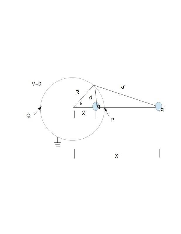

I offer some suggestions for solving this problem with respect to the "method of images". First, because the system cylindrical longitudinal symmetry, it can be reduced to two dimensions and we observe the the ##\vec E## field can only have a component normal to the cylindrical surface. That is, it can only have a component in the radial direction.
For the purposes of the method of images, in the diagram below, ##q## is the differential element of charge (##q=\lambda dz##) and ##q'## is the image charge. We take the cylinder to be grounded, that is ##V=0## on its surface. Let the potential due to ##q## be ##V(r,\theta)## and the potential of the image charge, ##q'##, be ##V'(r,\theta)## where ##r## is the radial distance from the center of the circle. At any point on the interior the total potential ##V_T=V+V'##. In order to find the unknown quantities ##X'## and ##q'## evaluate ##V_T## at point ##P## (##\theta =0##) and point ##Q## (##\theta =\pi##). You will get two equations for the two unknowns. Also, remember that ##E_r = -\frac{\partial V_T}{\partial r}##

Yes, but for the problem at hand the image-charge method is much simpler.
How would the potentials show the effect of the dielectric through the method of images?
Just consider #15. You'll see that outside the dielectric cylinder you have a potential looking as one where there's only a uniform line charge along the axis where the true line charge is present, but the effective line charge ##\lambda''## is different from the free line charge ##\lambda## due to the contribution from the polarization of the cylinder. Inside the cylinder you have the superposition of the true line charge and the image-line-charge located outside the cylinder.
