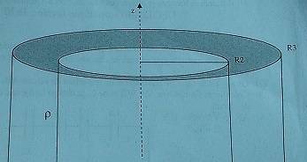

An infinite hollow cylinder charge is constituted of a sheath whose outer limits are R2 and R3. Wearing a uniform charge density ρ

For each of the other two cases, make sure you draw a picture showing your Gaussian surface.
