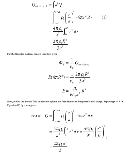

Handwritten-style derivation of the field of a sphere with charge density rho0 times (r/a)^3: enclosed charge integral Q within R = 2 pi rho0 R^6 / (3a^3), Gauss's law giving E = rho0 R^4 / (6 epsilon0 a^3), and total charge Q = 2 pi rho0 a^3 / 3.

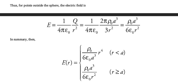

Typeset derivation of the electric field for a uniformly charged sphere, showing E = (1/4πε0)(Q/r^2) = (1/4πε0)(2πρ0a^3/3r^2) = ρ0a^3/(6ε0r^2) outside the sphere, followed by a piecewise summary E(r) equal to ρ0r^4/(6ε0a^3) for r < a and ρ0a^3/(6ε0r^2) for r ≥ a.
Still incorrect with the problem as stated. You are not using the density quoted in the problem statement.

I got the same fields as OP with ##\rho(r)=\rho_0\left(\dfrac{r}{a}\right)^3##. Maybe the discrepancy is due to careless typesetting in the statement of the problem in which the radius of the distribution appears ##R## instead of ##a##. The ratio ##r/a## is cubed in the solution, not multiplied by 3.
Yes, I am not sure why R and a have been switched, but the radius of the sphere is a.
The exponent is not the issue. The issue is ##a## or ##R## appearing in the ratio in the OP (which OP has now edited) and subsequently in the solution.
