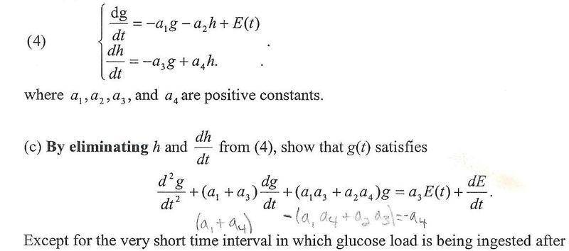

Handwritten-annotated printed system of ODEs: dg/dt = -a1 g - a2 h + E(t) and dh/dt = -a3 g + a4 h, followed by part (c) asking to eliminate h to show g satisfies d2g/dt2 + (a1+a3) dg/dt + (a1a3+a2a4)g = a3E(t) + dE/dt.
The writing below the equation is the correct order of the constants directly above it.
[tex] h=\frac{-g\prime-a_1g+E(t)}{a_2}[/tex]
So I solved for h in the dg/dt equation, and plug this into the h in the dh/dt equation. My question is where do I go from here to satisfy the relation given in the problem above.

Now you want to differentiate your expression for h and plug that result into the LHS of the dh/dt equation to get everything in terms of g and its derivatives.

So [tex] h=\frac{-g\prime-a_1g+E(t)}{a_2}[/tex]
becomes
[tex] h\prime=-g\prime\prime-g\prime+E\prime(t)[/tex]
which replaces dh/dt in the original equation?
You made a few mistakes. What happened to a1 and a2?

[tex]h\prime=\frac{-g\prime\prime-a_1g\prime+E\prime(t)}{a_2}[/tex]
So this result replaces the left hand side of the dh/dt equation in the original system.
Also, dg/dt from the original equation [tex]dg/dt=-a_1g-a_2h+E(t)[/tex]
becomes
[tex]g\prime\prime=-a_1g\prime-a_2h\prime+E\prime[/tex]
and plug in dh/dt into this equation, making
[tex]g\prime\prime=-a_1g\prime-a_2(-a_3g+a_4h)+E\prime[/tex]
