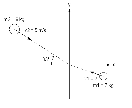

Mass m1=7kg with speed of 3 m/s collides at the origin with a mass m2= 8 kg that has a speed of 5 m/s, (at an angle of 33 degree in the 2nd qwuadrant). After the collision , mass 2 remains at rest at the origin. Find the final velocity of mass 1 (magnitude and direction).

I think you should make your own drawing and post it, because your descriptions all seem to be self-contradictory to my (perhaps limited) understanding!
ok this is the picture
Mass m1=7 kg with a speed oof 3 m/s collides at the origin with a mass m2= 8 kg that has a speed of 5m/s, as shown. After the collision, mass 2 remains at rest at the origin. Find the final velocity of mass 1 (magnitude and direction).
Momentum must be conserved in the collision. Which body has nonzero momentum after the collision occurs? What are its component values?
Object m1 one has non zero momentum after the collision. I would say the components are m1v1 I tried doign this. vf= 2(7kg)/ 7kg+8kg times 3m/s if is that what are you telling... it did not give me the answer.

Momentum is a vector. It has components. What is the momentum vector of the system before the collision?
I know that momentum is a product of mass times velocity and that velocity has direction. And the product of a scalar quantity and a vector quantity is a vector quantity. for m2 it would be M2cos(33)(5m/s) southwest, and m1 is m1cos(147)(3m/s) east. is that right?
The components of a vector should be parallel to the axes. That is, they'll be either positive or negative on the x-axis or y-axis.
Your drawing shows m1 initially traveling in the negative direction on the x-axis. So its only contribution will be along the x-axis:-m1*v1, where v1 is its speed (3m/s). Mass m2 is initially traveling more or less "southeast", and we'd expect it to have a positive contribution along the x-axis and a negative contribution along the y-axis. Use trig and the given angle to calculate its two components.

The x and y components of the momentum must be kept separate. Also include the velocity;
Px = m*v*cos(θ), Py = m*v*sin(θ).
For these types of problem it is often best to start out by finding the x and y components of the velocities of the objects first. Then the momentum components can be obtained by multiplying each by their masses. Sum the like components of the momentum for each of the objects to find the total momentum components.
Ok so you are saying that I have to sum Px = m2*v2*cos(θ) -m1*v1 then Py = m*v*sin(θ)-m1*v1?? sorry man i having trouble grasping what you are saying.
i give up dude. I have no idea what you are saying. I don't see exactly what you mean. This one is too difficult.
You want to find the total momentum vector for the system. It will be a conserved quantity in any system.
Each individual body has its own momentum vector. You want to find those vectors and add them all together. To do this you first need the momentum vectors in component form (components in the x and y directions). Hence m*v*cos(θ) and m*v*sin(θ) for each one, using the appropriate values of m, v, and θ for each body.
Sum up all the x components. Sum up all the y components. That's your total momentum in its component form.

Can you show your numerical values for the components of P?
Py = m*v*sin(θ)= -(8kg)(5m/s)sin(33)
Px = m2*v2*cos(θ)+-m1*v1= (8kg)(5m/s)cos(33)-(7kg)(3m/s)
is that right?
ScienceGeek24 said:
Py = -m2*v2*sin(θ)= -(8kg)(5m/s)sin(33)
That looks fine. What numbers will you put to Px and Py?
I would put for Py=-21.78 kg/m/s
I would put for Px=12.54 kg/m/s

Where will the momentum be after the collision (in which body)? Can you find its velocity vector?
I think the momentum will be at object m1. How to find the velocity vector... hmm no i think i need help on that one.
What's the formula for momentum?
p=mv
But this is an ellastic collision wouldn't it be vf=(2m/m1+m2)vx and vf=(m1-m2/m1+m2)vy ??
