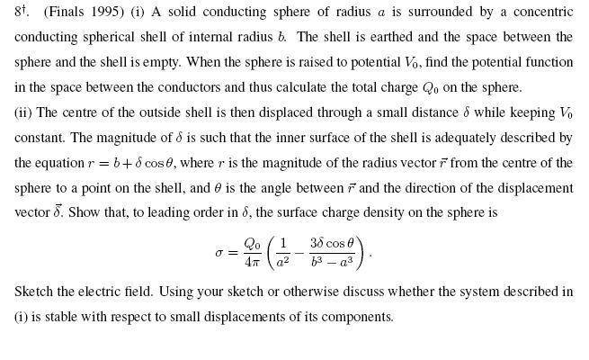

Hi, I've attached the question as I don't know how to write equations on here without them looking awful.
Laplace -> del^2 V=0
I've done the first bit (expression for Q0).
For the next bit I tried to solve laplace's equation to find the potential in the gap. I called the general radius of a point u, as r is already taken. I was then going to use the boundary condition that
-dV/du (at u=a) = charge density/permittivity of free space
Which is from the boundary condition for perpendicular field components, and the field must be zero inside the solid sphere.
I took delta to be along the z-axis, so the problem has azimuthal symmetry and we can use the usual general solution of
V = sum[Pl(cost) (Al u^l + Bl u^-(l+1))]
Where t is theta.
Looking at the answer given for charge density, I thought this V would only include an l=0 and l=1 term. So I used them and then used the boundary conditions that
V=0 at u=r=b + delta*cost
V=V0 at u=a
However this did not give me the result.
Any help? Thanks

Did you try the method of images?
