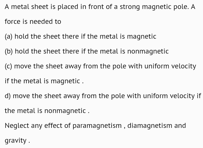

More than one options may be correct .
[/B]
Options a) and c) are correct . But I don't understand how non magnetic metal reacts to the magnetic field .
Is it in some way related to ferromagnetism ? But then either both b) and d) should be correct or both incorrect ?
If it is about ferromagnetism then relative motion between the magnet and sheet should not play any role .
Option d) is about relative motion between magnet and the sheet . I doubt whether it is in some way related to change of flux .
They don't, which is why the other answers are not correct.
Option d) is also given to be correct .
It is correct and as you said, it is due to electromagnetic induction.
Likes Jahnavi
cnh1995 said:
It is correct and as you said, it is due to the electromagnetic induction.
How ? It is a sheet not a loop .
Look up 'eddy currents'.
