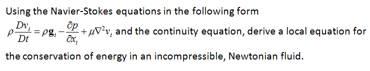

Energy conservation for a Newtonian fluid?
Display_Name
Typeset text asking to use the Navier-Stokes momentum equation rho Dv_i/Dt = rho g_i - dp/dx_i + mu del^2 v_i and the continuity equation to derive a local energy conservation equation for an incompressible Newtonian fluid.
ρ= density, vi = i-th velocity component, gi=i-th component of gravity vector, p=pressure, μ= viscosity, D/Dt = material derivative
Continuity equation: div v = 0

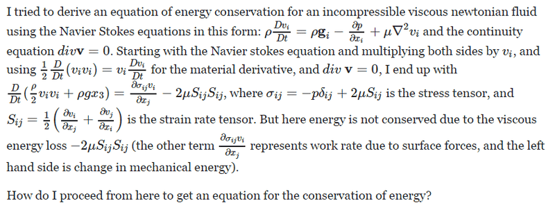

Typeset text with equations deriving mechanical energy balance for a viscous Newtonian fluid from the Navier-Stokes equations, including the stress tensor and strain rate tensor definitions.

The derivation you are looking for is in Transport Phenomena by Bird, Stewart, and Lightfoot. It involves dotting the equation of motion (momentum balance equation) with the velocity vector. Incidentally, this is called the Mechanical Energy Balance Equation. It can be combined with the Overall Energy Balance equation to yield the Thermal Energy Balance equation.
