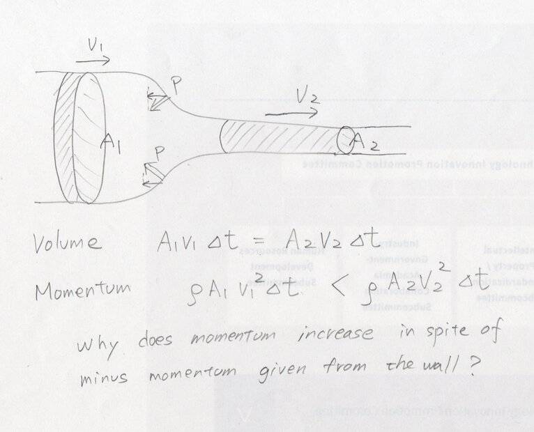

I am sorry it is just step aside but when I consider your problem I have got primitive question on momentum as sketched. I should appreciate you would teach me. Thanks in advance.
[EDIT] I add one more primitive question: What kind of energy and how does it contained in fluids as "pressure energy".
Thanks again.
It is easier to consider energy. Those forces don’t move so they don’t do any work. Which means that, from an energy perspective, their complicated direction and unknown magnitude can be neglected.
In any case, the direct answer to your question is obviously that the forces to the right are greater than the forces to the left.

  • #47
Forces (or pressures) you've sketched that have grip on the pipe wall do no work and so can't accelerate fluid. Reason is that these are normal forces of pipe surface and these are always perpendicular do direction of the flow (local fluid velocity) and so work of these forces is zero.
It is like work done by normal force when you pull some object on the horizontal surface or ground.
  • #48
Work would be zero but momentum change or velocity change might not be zero.
Say a ball bounce back from the floor, the ball speed changes sign by normal force from the floor which stays at rest.
  • #49
In your example, velocity or momentum does change, but not because of normal forces, but because of net work done by pressure forces on fluid.
Yes, if you bounce a ball perfectly elastically, velocity will have the same magnitude, but it will change direction. Since velocity is a vector, the change of direction of velocity vector requires a force due to Newton's 2nd law. This force is normal force.
In case of fluid flow, this force changes direction of local fluid velocity on pipe walls, but not its magnitude since work done is zero.
