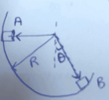

An object of mass m = 1 kg moves along a circular frictionless path of radius R = 0.5 m from point A to point B at which it makes an angle θ with the vertical direction as shown in the figure. If the object is release from rest (VA = 0) and θ = 30° , what is the normal force at point B (in N) ?
A ) 2.98 B) 25.98 C) 28.19 D) 29.54

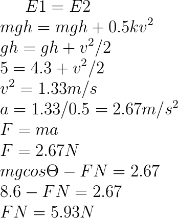

Here's my work :
%5CF%3Dma%5C%5CF%3D2.67%20N%5C%5Cmg%20cos%20%5CTheta%20-FN%3D2.67%5C%5C8.6-FN%3D2.67%5C%5CFN%3D5.gif

Your work is wrong. What is k?
You can not write gh=gh+0.5v^2. It means that the v2=0.

K is a typo. It should be m
gh1 = gh2 + 0.5 v^2

It is better now, but your v2is wrong.

I found the mistake. The height in B, I should substract it from 0.5
The answer is 25.98

Well done!
