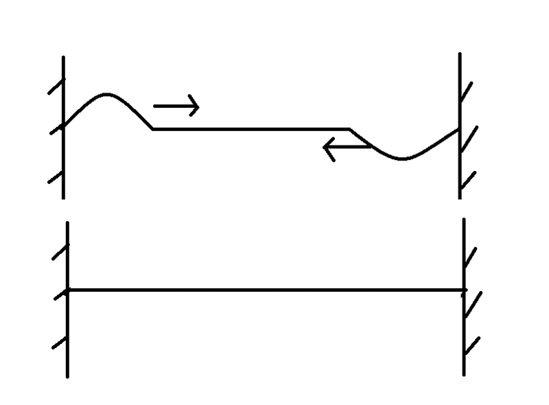

Suppose I have a string that has completely no motion.
at t=0, I give it energy, two waves.
at t=t'. I see destructive interference from the two waves.
question: At t=0, the net energy must be positive, >0, then at t=t', where is the energy?
(let the waves "meet" at x=L, most of the points at x=L during destructive interference has speed zero, so K.E.=0 , and if all the energy become P.E., then what is the difference to a string without any energy at the first place?)
Thanks for reading :D

Just because displacement is zero, does not mean that velocity is zero. If you take a guitar string and excite it to its first harmonic (ie. d=\lambda/2), while swinging back and forth, twice every period the string will have a displacement of zero (relative to a motionless string), but a non-zero velocity in the direction normal to the string.. In your example, when the two waves meet, the left part of the string will have a downwards velocity whilst the right part will have an upward velocity. Energy gets conserved.
Hope that helped :)
I would be interested to learn how you think you could cause a string, stretched between two fixed points, to take up the shape you have drawn?
If you pluck it at the points show, upwards on the left and downwards on the right, the centre portion will tilt between the two peaks. Thus you will have a central node plus one at each end.
What you will not achieve is the generation of two traveling waves as shown, nor the destructive interference you describe.
Once you realize this you will see that the energy you input will be manifest a standing wave with three nodes and two anti nodes.

well, let x=L, where the waves meet, at x=L, its velocity must be zero, because displacement must be zero DURING destructive interference ALL THE WAY.
Well, I can always cause such waves (say, using my hands) and then tie the string on the wall...
Maybe I should clarify my question:
Where does the energy go when destructive interference happens?
(given KE always >0, one of the P.E. <0, another P.E. >0, therefore, the net energy must be >0, when destructive interference happens, the region around the midpoint must have zero velocity such that during the whole destructive interference, the positions(around the midpoint of the destructive interference) remains zero.

Sorry, but it doesn't matter how many times you repeat that statement, it is just WRONG. See any textbook on dymamics, or mathematical physics, that gives the general solution of the 1-dimensional wave equation.
The OP's diagram is perfectly reasonable picture of the general idea of two "equal and opposite" transverse traveling waves moving along a string, and it is quite easy to make a real string behave like that.
Take an arbitrary wave whose shape is given by a function F(x).
The d'Alembert solution of the wave equation says this shape can travel in either direction along the string with a fixed velocity c.
So if the string has length L and you started two equal and opposite traveling waves from either end, the displacement of the string is given by
u(x,t) = F(x - ct) - F(x - L + ct)
When the waves "meet in the middle" at t = L/2c, you have
u(x,L/2c) = F(x - L/2) - F(x - L/2) = 0
which means there is destructive interference and the displacements are zero everywhere.
But the velocity is given by
u'(x,t) = -cF'(x - ct) - cF'(x - L + ct)
and when t = L/2c that is equal to
u'(x,L/2c) = -2cF'(x - L/2)
which is NOT zero everywhere, since F and therefore F' can be any shape of wave traveling along the string.
Note the "mathematical" reason for this is the sign change between the displacements and the velocities, caused by the fact that the waves are traveling in opposite directions.

I think most thought the original sketch OK on first viewing. I certainly did.
However the string is clearly shown stretched between two walls. Do you mean jiggle the whole system, walls and all, up and down?
I agree that if A and B are not fixed points then you can snake the ends of a string up and down and send traveling pulses along it for some distance if it is slack enough. How far the pulses will get will also depend upon the characteristics of the string.
If you do not fix A and B how do you induce and maintain tension in the string?
If you fix at one point, say A, pull out at B to obtain tension and jiggle up and down, you will have a time independent node at A and an antinode at B, by definition a standing wave.
