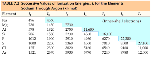

No. It is true that you must put more energy, but actually not so slightly. If you look at this table you can see that the second ionization energy is much higher than the first one.
I think your problem might be that you're confusing the second ionization energy with the total energy required to take both electrons out. https://en.wikipedia.org/wiki/Ionization_energy
