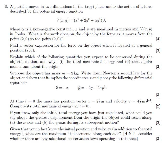

Printed exam question 8 on a particle moving in the (x, y) plane under the potential energy V(x, y) = (x² + 2y² + αy⁴) J, with parts on work done, force, conserved quantities, Newton's second law, energy and maximum displacements.
I don't know how to do the last part. What are the additional conservation laws? I don't think momentum is conserved because there is force acting on the particle. I don't think angular momentum is conserved too because there is a torque acting on the particle.

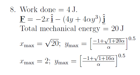

Here is the numerical answer:
Typeset homework solution: Work done = 4 J; force F = -2x i - (4y + 4 alpha y^3) j; total mechanical energy = 20 J; x_max = sqrt(20), y_max = [(-1 + sqrt(1+20 alpha))/alpha]^0.5; x_max = 2, y_max = [(-1 + sqrt(1+16 alpha))/alpha]^0.5.
  • Printed exam question 8 on a particle moving in the (x, y) plane under the potential energy V(x, y) = (x² + 2y² + αy⁴) J, with parts on work done, force, conserved quantities, Newton's second law, energy and maximum displacements.

  • Typeset homework solution: Work done = 4 J; force F = -2x i - (4y + 4 alpha y^3) j; total mechanical energy = 20 J; x_max = sqrt(20), y_max = [(-1 + sqrt(1+20 alpha))/alpha]^0.5; x_max = 2, y_max = [(-1 + sqrt(1+16 alpha))/alpha]^0.5.
