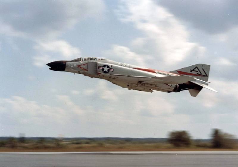

Just to note that the F-4 (Phantom Jet) of the 1950s and later, which looked like a brick could fly because it was given enough power.
