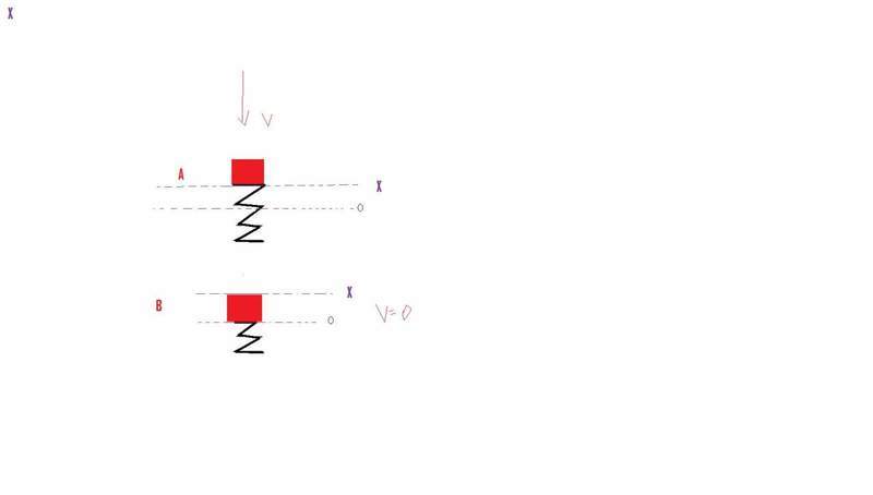

1.- An elevator(920 kg) is being hanged from a rope until it breaks from a height of 28 m upon a big spring (k= 2200000N/m) at the bottom.
a)Work done by gravity?
b)Speed just before it lands on the spring?
c)How much does it compress?

"-Wd= - mgh = - 252705.6 (a) (can this be done?)"
be careful with the signs, I'm not really sure It's negative, depends where is your zero point.
But let's say The zero point is where the spring , than work done by gravity equals to the change in kinetic energy=positive=mg(h).
than mgh=mv^2/2
V=sqrt(2gh) You have the speed hitting the spring,You've done that. so this is cool.
now,here i think something is messed up,
we have a spring , and mass hitting the spring with certain velocity, I'm attaching a picture which may help u solve it, but I'm not really sure myself , Do You have final answers?
anyway some questions to get You through the attached file;
What Kind of energy does it have in position A?
and after compressing X what kind of energy it has in position B?
HINT:
ITS NOT ONLY KINETIC ENERGY IN POINT A!
That's how I'd solve it...
About the second question, Let's first finish this one.
good luck!
No, the teacher didn't give me the answers, and I don't know how to take in consideration the weight since I'm already using the energy of the spring minus the speed, I thought that gravity was done for? :confused:
I think:
in A it has potential energy mgX (X is the how much the spring will be compressed)
and kinetic energy.
in B it has zero kinetic energy zero gravitational potential energy and k*X^2 /2 elastic potential energy.
by conservation of energy ...
try to solve it.
good luck
