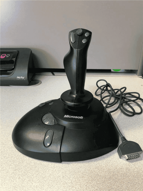

This may be a bit out of date, but I think something like this might suit your requirements -- it uses a standard game port: https://www.ebay.com/itm/Microsoft-Sidewinder-Precision-Pro-Joystick-X03-57540-/223044020414

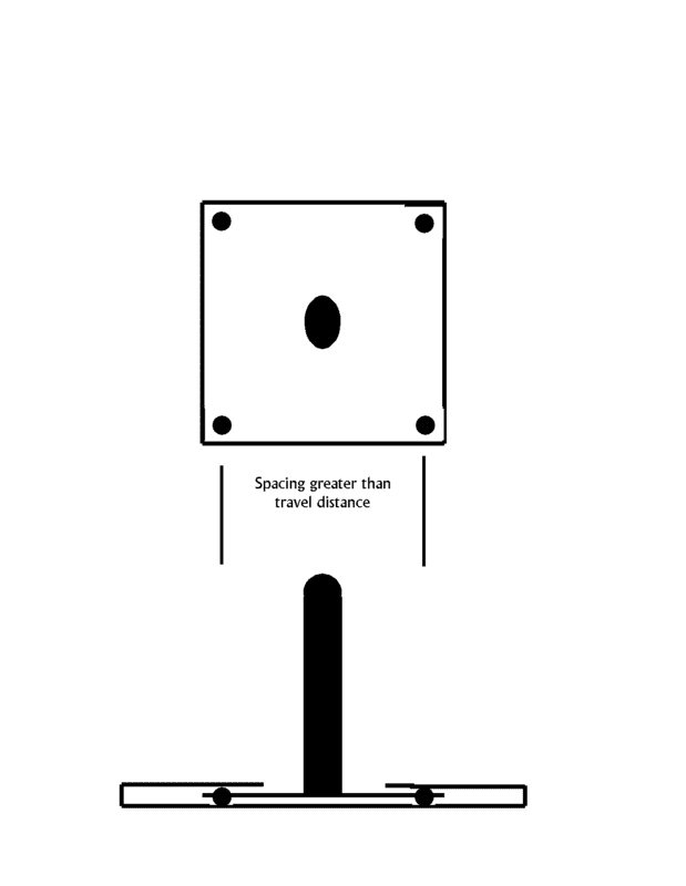

Here is a sketch for the mechanics. Sensing is left as an exercise for the reader. o_O
The 'Stick' is mounted on a plate. The plate has eight surface-mount ball bearings, four on top and four on bottom. An alternative could be Nylon slides.
The plate with Stick slides freely around in a thin box. The box dimensions and opening size it the top define the travel range.Pilot Stick.png

But that arrangement does not eliminate rotation of the stick.
How to sense the separate movements for elevator and ailerons and communicating those to the computer?
Some kind of anchoring to the desk will be needed, since you will be imposing moments and sliding forces on the base, things that articulated yokes don't suffer.
Yea, I thought of that while waking up this morning. Came up with a fix, I think, but it got a bit involved.

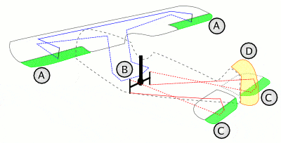

Regular flight simulators and radio control transmitters have two separate angular sensors (rotating potentiometers) that are simultaneously manipulated by a common lever.
One senses pilot's inputs for rolling the airplane sise to side via ailerons, which are control surfaces located by the trailing outer edge of each wing (A surfaces in animation of post #6).
The other senses pilot's inputs for pitching the airplane nose up and nose down via elevators, which are control surfaces located by the trailing edge of the horizontal stabilator (C surfaces).

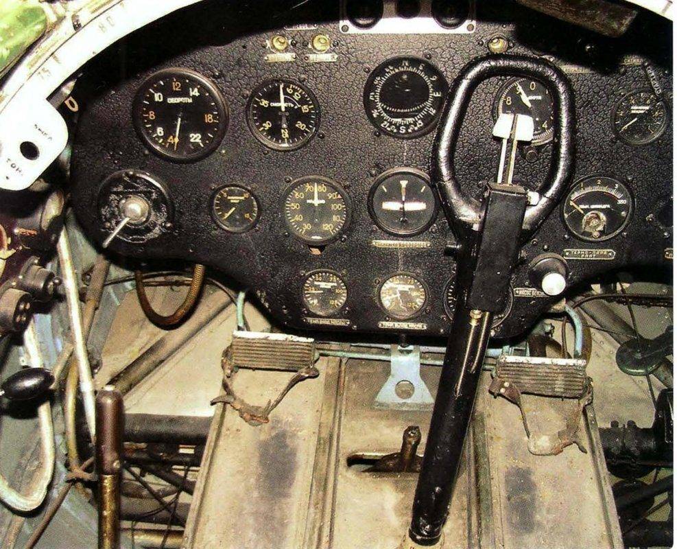

Also, it appears that a picture is worth a thousand words in this case, so I got this random picture off the internet of a Russian WWII fighter cockpit. You can see that the stick is attached to the floor, and at full deflection off to one side, the handle is barely angled, and it will travel several inches before it reaches the other side. I was looking for a desk-mounted solution that would imitate that movement.
I'm on my tablet, so not easy to draw any thing, but it seems to me that you could use two inverted domes, with a radius matching the floor to stick length. The larger dome would be mounted on the table, a smaller one, with stick attached would ride on top. I guess you would need a third one with a hole in the center to restrain the one with the stick.
