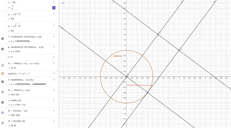

So I've made a simple Epstein diagram. Length of a ship is 1, v is 0.6c. Length contraction is visible, time dilation is visible.
So far so good, let's now look at this (I only added a red line)
How a stationary ship (red line), transforms into a line O1 D1. It feels like four vector is not conserved here. The question is: how do you draw a diagram of how the red line transforms into O1 D1 over time. Both the front of the ship and the back of the ship should travel the same distance in spacetime (not space).
Epstein diagrams are not spacetime diagrams. There are no coordinate charts and therefore no transforms. The red line isn’t a thing that has any physical meaning.
What do you mean by "transforms over time"? Transforms change between frames and they apply to a whole frame - transforming over time doesn't make sense. Do you mean, the ship accelerates from rest to 0.6c? If so, what happens depends on the acceleration profile. Is it Rindler acceleration so that the rocket maintains its proper length?
Whatever it is, write down the ##x(t)## coordinates of a family of points along the length of the ship, compute ##x(\tau)##, and plot.
Additional: you haven't really explained your graph. What are the four lines meant to represent?
Also, note that the representation of an object on an Epstein diagram depends on its history, not just its current state. I would not necessarily expect the final state of an accelerated ship to look like that of an eternally inertial ship with the same speed.
eternally inertial ship with the same speed looks the same in the diagram, eternally. It's just OB and CD lines extended to the infinity.

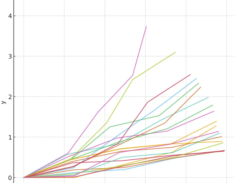

For example, a bunch of particles,
The length of a curve is always the same. You can see how far away each particle got (x axis). And how old each particle is (y axis). How do I do this for a ship?

The only things that are physically meaningful on that diagram are OA and OB. Additionally the dashed lines are not physically meaningful but do have an interpretation in terms of Einstein synchronization.
Nothing else on the diagram is meaningful. In particular, CD is not physically meaningful and has no interpretation in terms of Einstein synchronization.

I think CB is the position of the nose of a moving ship and OD is the tail. I presume their clocks are supposed to be synchronised in their rest frame.
You also seem to have drawn a second set of axes on the chart, which makes no sense. You are plotting proper time vertically and this is an Epstein diagram. Diagonal lines are not the axes of other frames.
