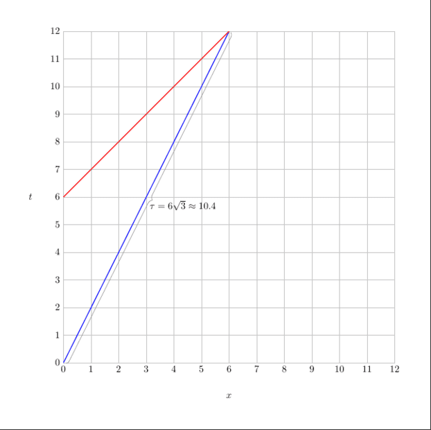

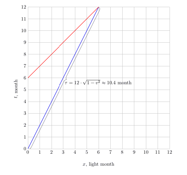

The ship left Earth at a speed of 0.5c . When the distance between the ship and Earth was 0.25 light year, a terrorist was caught on Earth who said that he had planted a bomb at the time of departure and activated it for 10 months. At that moment, a warning signal was sent from Earth.
The diagram looks like this
Spacetime diagram with x axis from 0 to 12 and t axis from 0 to 12. A red line runs from (0, 6) to (6, 12). A blue line runs from the origin to (6, 12), and a grey line runs nearly parallel just to its right. Labelled tau = 6 times the square root of 3, approximately 10.4.
According to the ship's clock, $$\tau = 12\cdot \sqrt{1- \left(\frac12\right)^2} \approx 10.4 $$months have passed, so the ship must explode.

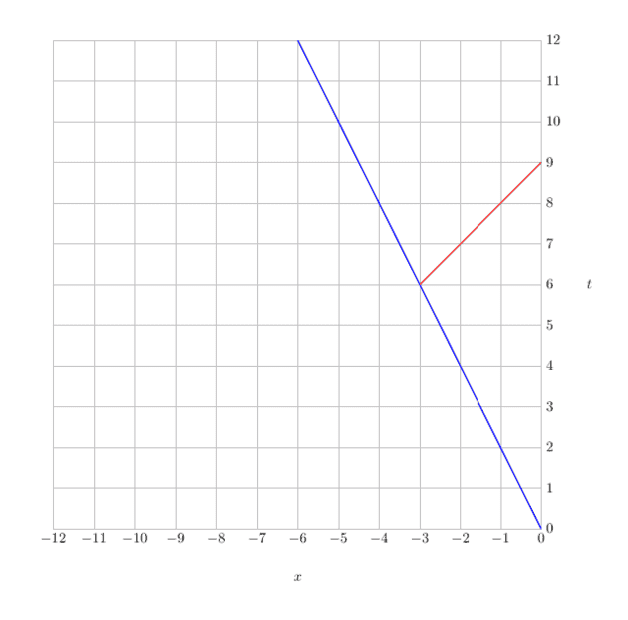

The question is this. What would the diagram look like in the ship's frame of reference? The ship is already stationary and the earth is traveling at [itex]-0.5c[/itex].
Spacetime diagram with x axis from -12 to 0 and t axis from 0 to 12. A blue line runs from (0, 0) up to (-6, 12), and a red line runs from (-3, 6) up to (0, 9).
This diagram contains an error, according to the previous diagram, there should be 10.4 months, but this one shows 9 months. I must have forgotten something and forgot to account for it. How to draw the diagram correctly from the ship's point of view?
It is almost always the relativity of simultaneity. The message is not sent at ##t=6## in the ship frame.

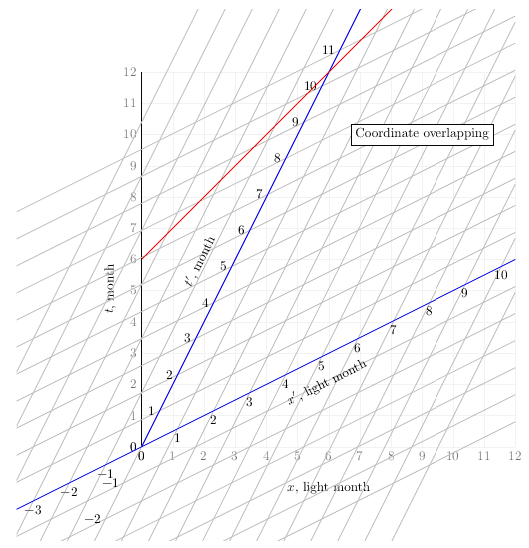

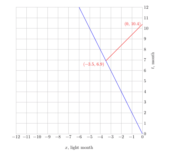

I'll summarize. Thank you to everyone who responded and helped me.
Earth frame
Spaceship's Frame
Note that the Doppler factor for [itex]v/c=0.5[/itex] is [itex]k=\sqrt{\frac {1+v/c}{1-v/c}}=\sqrt{3}[/itex], which is about 10.39/6.
By the way, once you know 10.39 is the wristwatch time of the receiver when the signal received,
in your receiver frame, you can draw a past-directed light signal from 10.39 on the receiver worldline.. and locate the intersection event with the source worldline.
