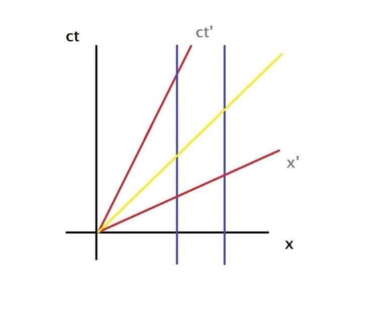

On my diagram, a person is traveling in a spaceship to the right in red, which is displayed as a Minkowski diagram . At the origin (0,0) the person traveling travels by a stationary person. And the 2 blue lines are the worldlines of two blue stationary rocks.
But when I try to figure out what the distance is between the rocks from the frame of reference of the spaceship at (0,0), I get a distance wider than the proper length. What am I doing wrong?

We can't possibly tell unless you show us your actual calculations.

At a guess, you calculated ##x'## for each rock at the same ##t## and took the difference, which is larger than the rest spacing by a factor of ##\gamma##. But two events with the same ##t## do not have the same ##t'##. The rocks are moving in the primed frame, and if you compare the position of one at one time to the position of the other at another time you do not get the separation. If you want their separation as measured in the primed frame you need to measure their positions in that frame at the same time in that frame. That is, you want the difference in ##x'## at the same ##t'##, not the same ##t##. That separation is smaller by a factor of ##\gamma##.

Ok, I was wrong. You just measured the length of red ##x'## axis between the blue lines, which gets you ##\sqrt{\Delta x^2+c^2\Delta t^2}##. That is not the length of the line in reality - it's only the length of the line on the diagram. As you may recall from your last very lengthy thread, the Minkowski diagram is a distorted representation of the non-Euclidean Minkowski plane. That means you can't just measure lengths on the diagram and hope. You need to calculate.
Remember that the length of a spacelike line is ##\sqrt{\Delta x^2-c^2\Delta t^2}##, not ##\sqrt{\Delta x^2+c^2\Delta t^2}##.

You can't just look at spacetime diagrams and judge by what "seems" to be the case. The geometry of Minkowski spacetime is not the same as the geometry of a Euclidean space, which is what your "seems" intuition is used to. You need to actually do the math.

The x-axis and the x'-axis have different scales.

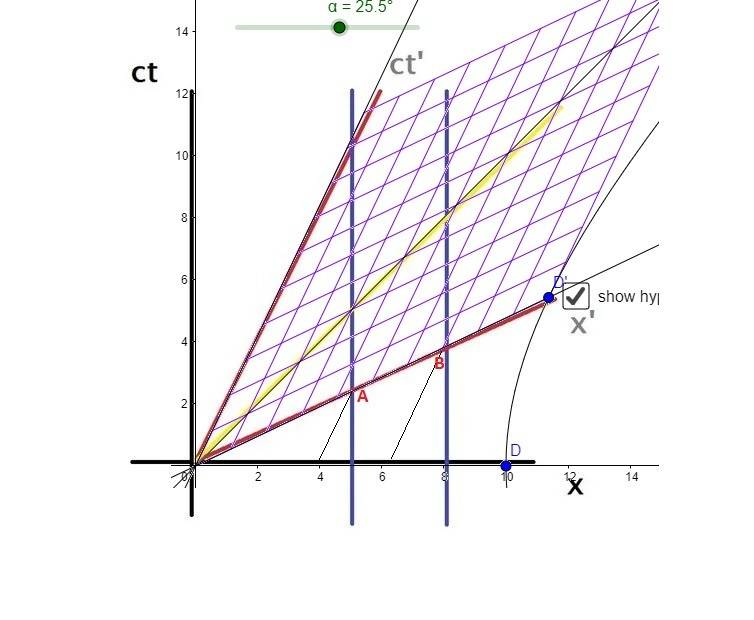

In the following overlay of GeoGebra and your diagram, you can see scales at the axes.
Minkowski spacetime diagram with ct vertical and x horizontal, showing boosted axes ct' and x' at alpha = 25.5 degrees, a purple grid, events A and B on the x' axis, and event D' marked near x = 11.
##\beta \approx \tan (25.5) \approx 0.477##
##1/\gamma \ \approx 0.88##
##L = 3, \ \ \ L' = 2.64## (measured at events A and B).
Now consider a rod between events A and B, that is at rest in the spaceship and has the length M' = L'. Length contraction of the rod in the stationary frame:
##M' = 2.64, \ \ \ M = 2.32##.

Thanks, I did not know that they were different scales. It makes sense now.

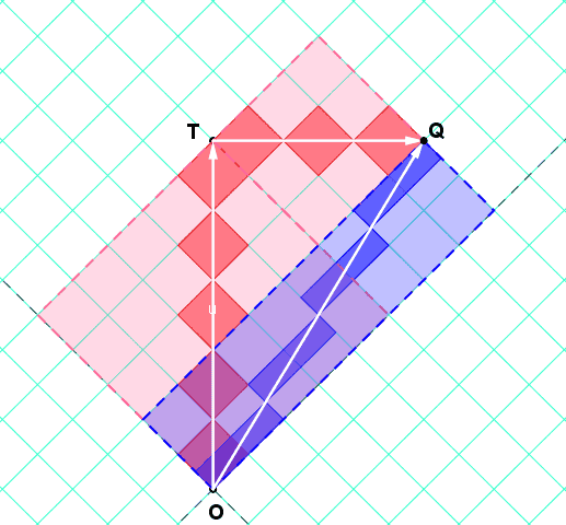

Here's another spacetime diagram that might help.
By using "rotated graph paper",
many calculations can be done by counting and doing very simple arithmetic.
The boxes in the grid ("light-clock diamonds") are based on the light-clock of the observer at rest who draws this diagram.
By forming the "causal diamond" where your events are opposite corners
and the diamond-edges are along the lightcone, the area of the diamond (in units of the light-clock diamond) gives the square-interval between those events. The square-root of the magnitude gives the "length" along the diagonal of the diamond.

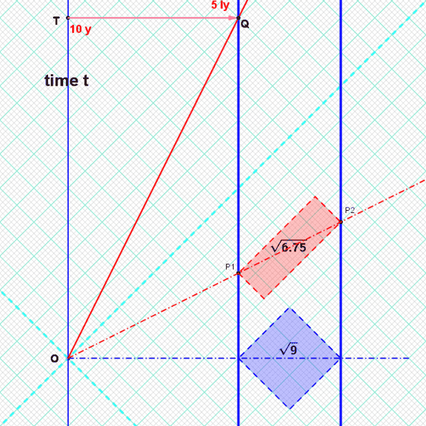

I tried to reconstruct the situation you have drawn.
It seems that your moving frame moves at ##v=(0.5)c##, and your rocks are at ##x=5## and ##x=8##.
By computing the areas, you can see that the moving frame measures a shorter distance between the parallel worldlines.
(t,x) coordinates: P1=(2.5, 5) and P2=(4,8)
The square-interval (using the ##(+,-,-,-)##-convention ) is ##(4-2.5)^2-(8-5)^2= -6.75##
Note: for ##v=(1/2)c##, we have ##\gamma=\frac{1}{\sqrt{1-v^2}}=\sqrt{4/3}##. Furthermore,
$$(\ell')^2=\frac{\ell^2}{\gamma^2}=\frac{9}{4/3}=(27/4)=6.75$$

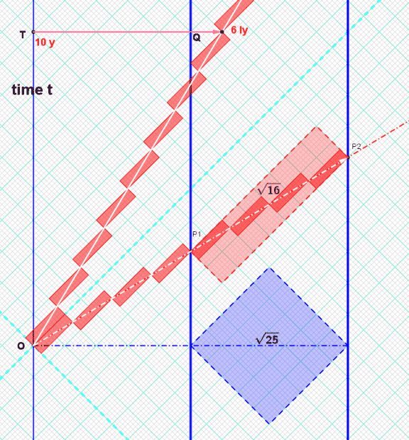

If you choose nice numbers (like ##v=(3/5)c##, which have rational Doppler factors, here ##k=2##
(whereas ##v=(1/2)c## has ##k=\sqrt{3}##)), the arithmetic is easier (especially when used with nicer intervals, like 5 (rather than 3) for ##v=(3/5)c##) and the visualization of the ticks along the segments is easier... assuming the primary goal is to first have an understanding of what is going on... before moving on to solving more general problems.
With ##v=(3/5)c## (so, ##k=\sqrt{\frac{1+v}{1-v}}## and ##\gamma=\frac{1}{\sqrt{1-v^2}}=5/4##)
and ##\ell=5## (between ##x=5## and ##x=10##).
Spacetime diagram on rotated grid paper with time t vertical; a red-dashed light-clock diamond spans P1 to P2 labelled sqrt(16), a blue diamond below labelled sqrt(25), and blue vertical worldlines at two positions.
For more on this approach, consult my Insights (first link in my signature below).

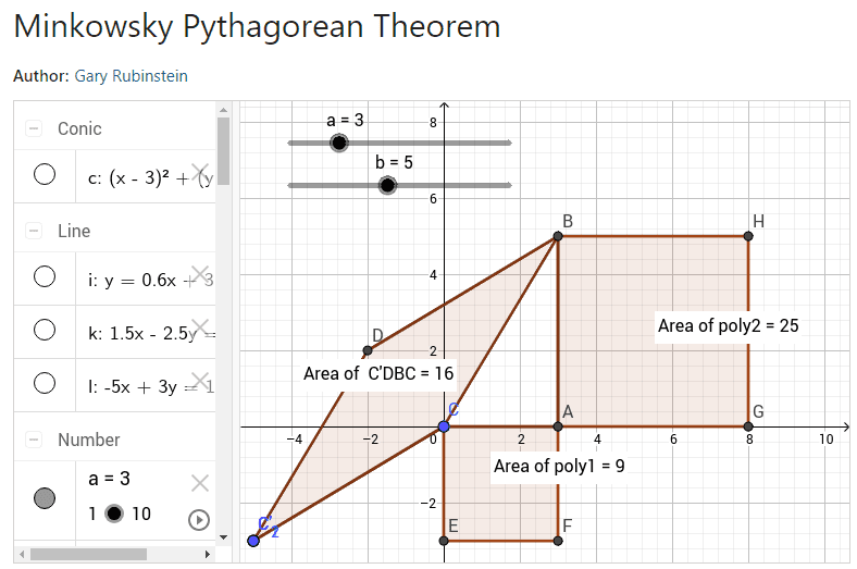

In the Minkowski diagram you can also construct an area (based on a non-rotated graph paper), which is the squared interval between those events. It is the area of the rhombus (symmetrical with regards to the light world lines), with the events at neighboring points, in the following link events C and B:
https://www.geogebra.org/m/dYyg5ZB8#material/ewe6t2BU
Proof:
https://www.geogebra.org/m/HCBWqpjY
See also:
http://www.dierck-e-liebscher.de/images/geometrie/minkowski-pythagoras.html

  • GeoGebra plot of Minkowski Pythagorean theorem: square on segment CB labelled Area of C'DBC = 16, square on AB labelled Area of poly2 = 25, square on CA labelled Area of poly1 = 9, with sliders a = 3 and b = 5.
  • here's my version of the Pythagorean theorem.
    Spacetime diagram on a grid of light-cone lines showing points C, T and B, with a pink causal diamond between C and T and a blue causal diamond between C and B, and white arrows from C to T and C to B.
    ##(area CT)^2-(area TB)^2=(area CB)^2=25-9=16##.

    the observer along the timelike diagonal of the blue diamonds.
    Since the area is ##uv=(4)(4)##, the square interval is 16
    (in agreement with what is determined by ##\left(\frac{u+v}{2}\right)^2-\left(\frac{u-v}{2}\right)^2=4^2-0^2##)).
The blue clock diamond obtained by stretching the red diamond by a factor of k=2 in the forward direction and shrinking by that factor (so the area is unchanged) is a Lorentz boost in the eigenbasis… in light-cone coordinates.
For a more detailed example of a diagram and calculation using the diamonds
look at page 9 of my slides (from an old talk) describing an elastic collision
https://www.aapt.org/docdirectory/m...aper-CalculatingWithCausalDiamonds.pdf#page=9
On one diagram, it features 4 reference frames (the lab frame, the two frames for the initial particles, and one frame for one of the final particles)... the 5th frame is not yet determined until the problem is solved
...by counting diamonds,
  • GeoGebra plot titled Minkowski Pythagorean Theorem: a coordinate grid with sliders a = 3 and b = 5, points A, B, C, D, E, F, G, H, shaded polygons labeled Area of poly1 = 9, Area of poly2 = 25 and Area of C'DBC = 16.
  • Spacetime diagram on a light-cone grid showing points O, T and Q, with a timelike arrow from O to T and a boosted arrow from O to Q, and shaded diamond regions in pink and blue.
