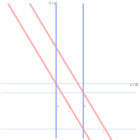

Simple case of two rulers moving past one another in constant relative motion both in inertial reference frames.
In the case of two rulers of equal rest length moving past one another ibex posted the minkowski diagram and I have a question about the one diagram that follows the following comment by him:
Note that, in the primed frame, "State 2" is after "State 3"! This is the relativity of simultaneity striking - the definitions of the states are anchored to spacelike separated events, and the ordering of spacelike separated events is frame-dependent.
Again we can transform this last diagram into the primed frame:
Now I wrote the formula for the equation of the line that goes from State two to State One in the primed frame and I got an interesting result that I want to share. Ibex can back me up on this.
The lower thick red line intersects the A' axis at
## \frac {L_0}{v}##

Here's the attachment of his diagram
Leepappas said:
I'll try to attach ibex's Minkowski diagram.
You don't have to, just give a link to the post that it's in.
Yes that's the one that I'm talking about. The fourth diagram down.
The slope of the thick lines is ##1/v##, as you can easily verify by looking at the stationary lines (##v=0##) which are vertical (gradient is infinite). Or by noting that the vertical axis is ##t'## and the horizontal is ##x'##, so the gradient of a straight line is ##\Delta t'/\Delta x'=1/v##. (Edit: this turns out to have been unclear. In general, the slope of a line is the inverse of its velocity, but that velocity is not necessarily the frame velocity ##v##. It would have been better to write ##\Delta t'/\Delta x'=1/u## for a general line with velocity ##u##, and then to note that ##u=\pm v## for the thick lines in this specific scenario. Note that not all lines represent physical objects and it is easy to draw lines for which ##|u|>c##.)
Your problem seems to be that you are attempting to interpret the equation of a line of constant ##t## or ##t'##, which describe (respectively) the red and blue fine lines in my diagram, as relevant to the thick lines, which are actually lines of constant ##x## (red) or ##x'## (blue). It isn't relevant, and your contradiction this time is in your mistaken assumption that it is.
If ∆t'/∆x' = 1/v then the slope is positive because v is speed, however the slope is negative in the primed frame. Now I don't understand what the problem is with using the Lorentz transformation this time hopefully you can help me out. what is wrong with saying the following:
##t= \frac{t'}{\gamma} + \frac{vx}{c^2} ##
So for constant t' the y-intercept is ##\frac{t'}{\gamma} ## and the slope is ## \frac{v}{c^2} ##.
Then applying your argument we get
## \frac {1}{v}= \frac {v}{c^2}## therefore
## v=c## but this is impossible in special relativity.
Why can't you use the slope intercept form of the equation of a straight line and apply it to one of the diagonal lines in the primed frame and then use your argument to get an alternative expression for the slope then equate them and get a contradiction. I used the Lorentz transformation which everybody insisted that I do. So what's my problem?
No, ##v## is velocity and is a signed quantity. That's why the slope is negative in this case where the sense of the motion is towards negative ##x##.

So for constant t'
The problem is that ##t'## is not constant along the thick lines. It's constant along the fine lines that represent a "now" for the primed frame, but the thick lines are the positions of the ends of the rods. You can't have constant time along those - that would imply they exist everywhere but only at a specific time. That's a fine definition of "now", but it is not how objects behave.

The other issue is that ##v## is doing double duty here. It's being used as both the velocity of some worldline and as the velocity of one frame with respect to the other. Since we've mostly been talking about objects that are at rest in one frame or the other that mostly doesn't matter, but it may be what is confusing you.
Let's call the velocity of some object ##u## in some frame. Then the slope of its worldline in that frame will be ##1/u##. In the case of objects that are at rest in one frame, their velocity in the other frame will be ##u=\pm v##. That also resolves your issue above, since you'll end up with ##u=c^2/v## for the "now" line of the other frame. Yes, this is greater than ##c##. That does not matter because "now" is not a physical object, it's just a line I drew on the graph.

You need to re-read #10. The problem is that I re-used ##v## as the speed of the worldline as well as the speed of the frame. Up to sign, that works out for the physical objects in this scenario because they're stationary in one frame and moving at speed ##\pm v## in the other, but you aren't using the equation of motion of any physical object. Again, you are using maths that works in a specific case in a more general setting.
Let the speed of the frame be ##v## and we will define the "speed" of a line (worldline or otherwise) as ##u##, where ##1/u=\Delta t/\Delta x## is the gradient of the line. That makes your "quadratic equation" turn into ##u=c^2/v##. That is not quadratic, but does give ##|u|>c##. This is not surprising because the line whose gradient you are studying is not a physical object. It's just the line a different frame defines as "now". You can call ##u## its velocity if you like, but nothing is travelling with that speed.
