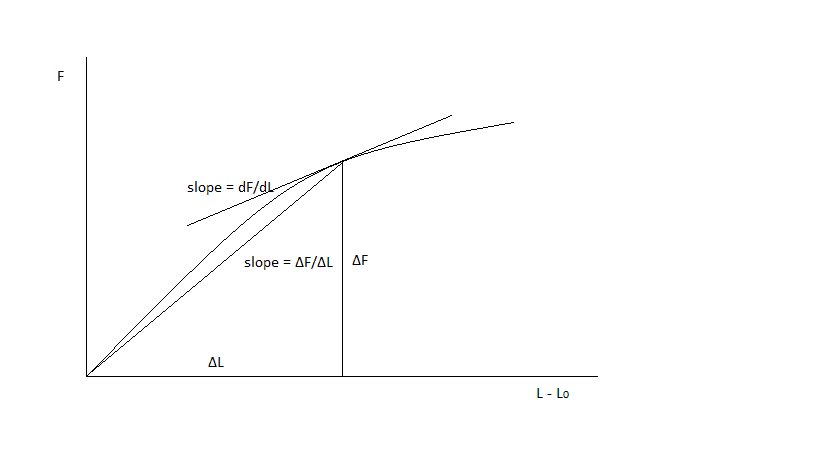

The difference between OP's two definitions is the difference between the tangent modulus and the secant modulus. The former is the slope of the tangent to the stress-strain curve at a given point; the latter is the slope of the line joining that point to the origin. That is, the former is the differential increase of stress with strain, the latter is total stress/total strain. The two are different if the stress-strain curve is non-linear. See diagram.
Force F against L minus L0 curve, a concave-down graph from the origin, with a tangent line labelled slope = dF/dL and a chord to the origin labelled slope = ΔF/ΔL, with ΔL and ΔF marked.
