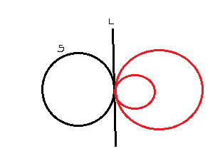

In my textbook, its given that the equation of family of circles touching a given circle S and line L is ##S+\lambda L=0##
So to find the equation of family of circles touching line L at point P(p,q), can i use the same equation taking S to be a circle of radius zero and center at P?
That is, if L is ax+by+c=0 and P is (p,q), then S will be ##(x-p)^2+(y-q)^2=0## and the equation of family of circles will be ##(x-p)^2+(y-q)^2+\lambda (ax+by+c)=0##. Is this correct? such a circle passes through P.

Your image doesn't show any coordinate system, but your equations here assume that there is one. Is the line vertical? If so, its equation will be x = k for some constant k.
If the radius of your circle is 0 and its center is at (p, q), this is a degenerate circle (a single point). Note that if ##(x-p)^2+(y-q)^2=0##, then the only solution is x = p, y = q.

Lambda is a parameter. Its not a vertical line. Its just a rough diagram.
Yes. They add to zero when you substitute the point of contact of the given circle and the line. This is how the family of circles is specified. They all have to touch that point.

To get back to what you originally asked about, let me make a simplifying assumption; namely, that line L is vertical, and its equation is x = p. If C is any circle that touches the point (p, q) and whose radius is r, then its center must be at (p + r, q). The center of the circle has to be on a horizontal line that intersections the vertical line at (p, q).
The equation of the circle would be ##(x - (p + r))^2 + (y - q)^2 = r^2##. Note that if r = 0, this equation simplifies to ##(x - p)^2 + (y - q)^2 = 0##, and we get only the point (p, q). Also, if we allow r to be negative, we get circles on the other side of the vertical line. In this case, we would take the radius of the circle to be |r|.
