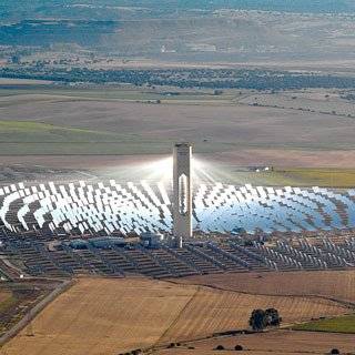

For my final project I have chosen to optimize a CSP (concentrating solar power) farm. As seen below:
Approach
My approach to optimizing the farm is comparing the height of the 'collector' to the diameter of the dish and depth, as well as how many dishes are used.

I found the error with my approach. The equations will lead to odd dimensions for the reflector, so I've decided to perform a polynomial interpolation on available prices for reflectors based off of the diameter, which is a variable found in the focal length equation. I can then minimize costs at the same time, hopefully leading to more reasonable values of D (dish diameter) and C (dish depth).
