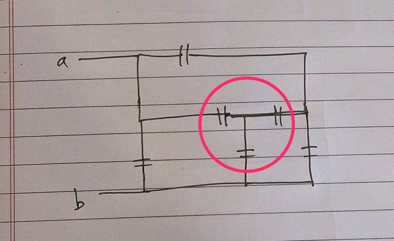

Equivalent capacitance and Kirchoff's laws
EddiePhys
144

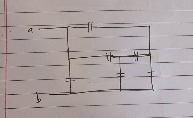

Hand-drawn circuit schematic between terminals a and b, with capacitor symbols on the wires forming a network of nested rectangles.
[/B]
I really have no idea how to proceed. Applying Kirchoff's laws to this would be quite lengthy. This circuit is supposed to be a wheatstone bridge but I can't see it.
See on internet some stuff about the star-delta transformations.
I don't want to say useless things, but I would apply this method here.
http://i65.tinypic.com/2mxfvps.jpg
  • Hand-drawn capacitor network between terminals a and b, with capacitors in a bridge-like arrangement; the central group inside a red circle is marked for a star-delta transformation.
scottdave said:
Actually, there is a Wheatstone Bridge (5 caps), but the Bridge is in parallel with 1 cap.
Oh I see it now. Thanks!
