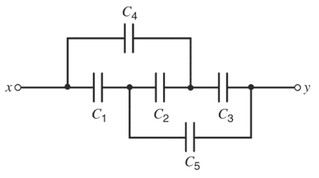

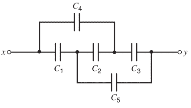

Find the equivalent capacitance between points x and y in the diagram below. Assume that C2 = 10 µF and that the other capacitors are all 4.0 µF.
in series: 1/C = 1/C1 + 1/C2
in parallel: C = C1 + C2
Circuit schematic of five capacitors C1 to C5 between terminals x and y: C1, C2 and C3 in series along the main wire, C4 arcing over the top from the node before C1 to the node after C2, and C5 arcing below from the node between C1 and C2 to the node after C3.
Why is it that, due to symmetry, ∆V2 = 0 and ∆V1 = ∆V4 = ∆V5 = ∆V3? I don't really understand the reasoning behind the simplification. Thank you.
It becomes obvious if you redraw the diagram. Remove 2 for the moment and draw the rest in a simple rectangle, then reinstate 2.

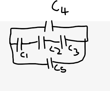

I know my diagram is probably drawn incorrectly,
Hand-drawn circuit diagram of five capacitors labelled C1 to C5 connected between two rails of a rectangular loop; C4 sits on the top wire, C5 on the bottom wire, and C1, C2 and C3 are in the middle branches.
What are my mistakes thought?

Why is it that, due to symmetry, ∆V2 = 0? If I remove V2, C1 and C4 (in parallel) are in series to C3 and C5 (in parallel). When I redraw V2, how I would be able to determine that V2 = 0? Thank you.

Completely incorrect.
@haruspex was replying to OP, who at least realizes that ∆V2 = 0 .

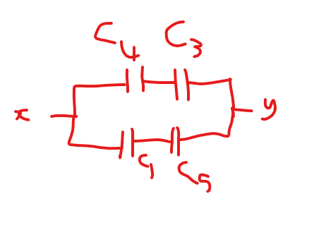

Take it in steps. First, remove C2, then straighten the rest of them diagram into a simple rectangle with two capacitors in series in the top line and the other two in the bottom.
Post those two.

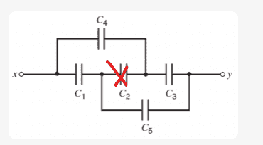

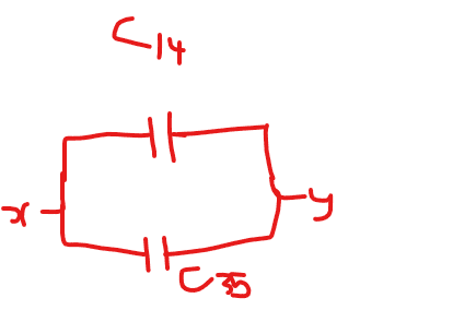

Here it is:
Step 1:
Circuit schematic of capacitors between terminals x and y: C4 on a top bypass wire, C1 and C2 along the middle wire, C3 to the right, and C5 on a bottom bypass wire. C2 is crossed out with a red X.
Step 2:
Hand-drawn circuit diagram with two capacitors in parallel between terminals x and y; the upper capacitor is labelled C14 and the lower one C5.

Not correct.
In the upper branch, you should have ##C_4## in series with ##C_3##.
In the lower branch, you should have ##C_1## in series with ##C_5##.

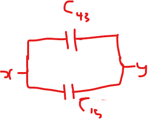

I think I see why they are not parallel now. It is because there along the wire there is another wire that splits off so not all the electrons join together again.
Here is my new diagram:
Hand-drawn circuit with two capacitors in parallel between nodes x and y: the top branch labelled C43 and the bottom branch labelled C15.

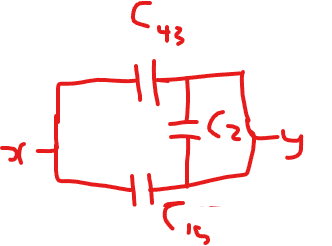

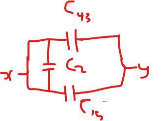

I think I see why the volage difference is zero now. Since capacitor two will cross between the two parallel branch's at either before or after the parallel capacitors as shown below: (I'm not sure whether you can tell where ##C_2## connects between the two branch's - Do you please know?)
Hand-drawn circuit schematic with terminals x and y. Capacitor C43 sits on the top wire, C2 in a middle branch, and C15 on the bottom wire.
Hand-drawn circuit schematic with terminals x on the left and y on the right. The top branch has capacitor C43 and the bottom branch has capacitor C15, with capacitor C2 connecting the two branches in the middle.
So since ##C_{43}## is in parallel with ##C_{12}## then their potential difference across each will be the same. Therefore, they will read the same potential at the same distance down each wire.

Do not connect the series pairs. Make a drawing with the four capacitors as @haruspex and I suggested.
Then consider how/where to connect ##C_2## .

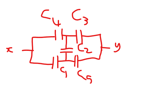

Here are the new diagrams,
Hand-drawn circuit schematic with terminals x and y at left and right; two branches each hold two capacitors in series, labelled C4 and C3 on the upper branch and C1 and C5 on the lower branch.
And I think we connect ##C_2## here:
Hand-drawn circuit schematic of five capacitors labelled C1 to C5 between terminals x and y, with C4 and C3 in the upper branch, C2 in the middle, and C1 and C5 in the lower branch.
Many thanks!
haruspex said:
Right. Do you see how the symmetry proves there is no potential across C2?
Thank you for your reply @haruspex !
Yes I think so, as along as the wires joining C2 to the circuit are perpendicular to the capacitors in series on each side then C2 and its wires will be equidistant from x so each side for the capacitor have the same potential and therefore have a zero potential difference
