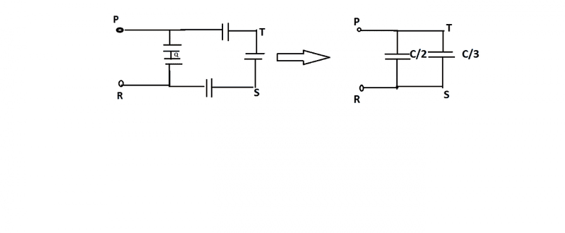

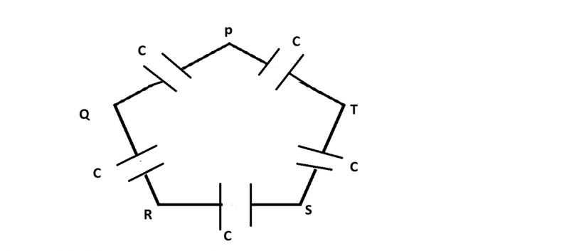

Five capacitors ,each of capacitance value C are connected as shown in the figure.The ratio of capacitance between P and R,and the capacitance between P and Q is
For Equivalent Capacitance in series
##\frac{1}{C}##=##\frac{1}{C_1}##+##\frac{1}{C_2}##
But I don't know from which direction should I consider capacitors whether clockwise or anticloclwise?Because I will encounter different number of capacitors in each of these direction.

Does it matter? is ##\frac{1}{C_1}+\frac{1}{C_2}## not the same as ##\frac{1}{C_2}+\frac{1}{C_1}##?What capacitors are connected in series and in parallel with respect to the terminals P and R, and in case when the terminals are P and Q?
Determine the equivalent capacitance between P and R. Then determine the equivalent capacitance between P and Q. What are they?
Now the two capacitors are in parallel
equivalent capacitance between P and R=C/2+C/3
=##\frac{5C}{6}##

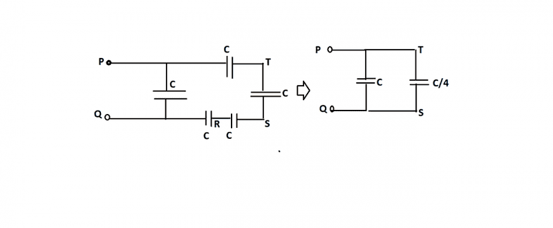

equivalent capacitance between P and Q is =C+C/4
=##\frac{5C}{4}##
The ratio between the two are
##\frac{5C}{6}##÷##\frac{5C}{4}##
=##\frac{2}{3}##
Am I right?

Looks good to me.
Splendid!
You did it right, the answers you got in one thread can be applied in an other thread. Do not forget them!
