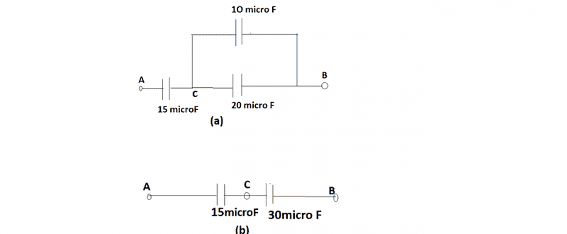

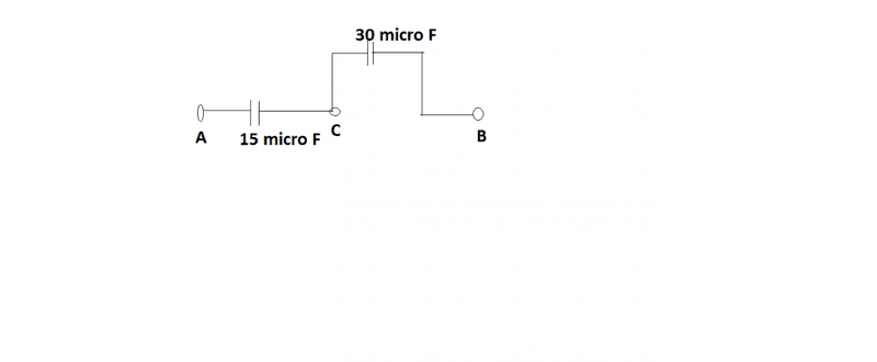

In the arrangement shown,find the equivalent capacitance between A and B.
Capacitance in parallel
##C##=##C_1##+##C_2##

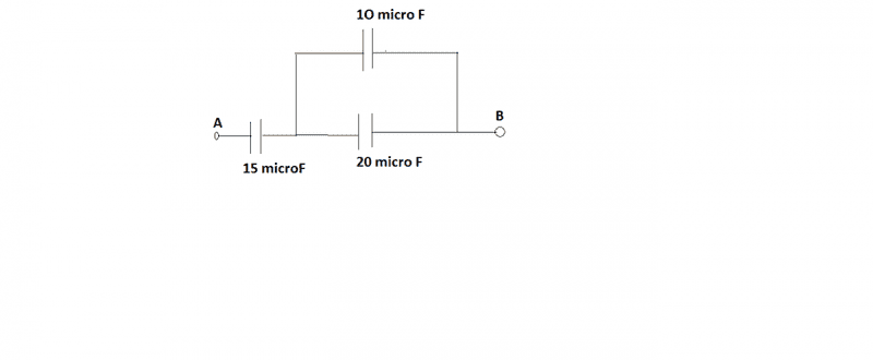

Supplied solution says
As,we can clearly see that ,capacitors 10μF and 20μF are connected between same points ##C## and ##B##(Parallel combination)
They can be replaced by a single capacitor of capacitance given by
##C##=10μF+20μF=30μF
Thus circuit can be shown by (b).
Now ,the capacitors 15μF and 30μF are arranged in a row(sweries combination)
the equivalent capacitance is given by C such that
##\frac{1}{C}##=##\frac{1}{15}##+##\frac{1}{30}##=##10##μF

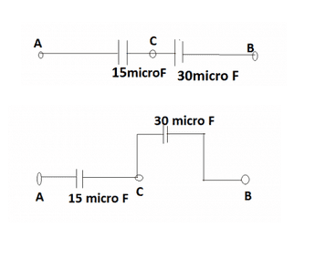

What I did not understand is
Why can't I replace them as fllows
Are you asking if there is a difference between these two?
Electrically, no: There is no difference. You can arrange circuit components in any way you wish on paper, draw wires or components at angles, make wires long or short, have wires wander all over the page, etc., and it will make no difference to the circuit. What matters is the topology of the network (what connects to what).

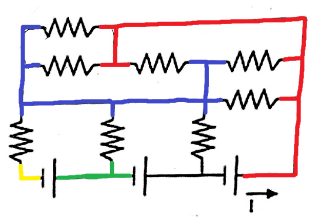

Can you please provide me easy tip for identifying which capacitors are in parallel connection and which are not?I can identify in simple cases but when it is complicated ,I can't.
Parallel components share two nodes for their connections. Series components have one node that they share exclusively (no other connections at that junction).

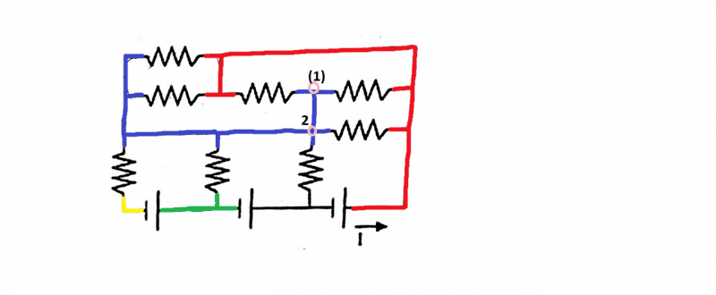

A simple visual aid for finding parallel components is to color each node a different color (that includes all the wiring that makes up a given node). Components that are in parallel will connect to the same two color pairs. An example from a recent thread involving simplifying a resistor network is demonstrative:
All the resistors that connect to the same color pairs are in parallel. Note that all the horizontally drawn resistors have the color pair (Blue, Red), so they are all in parallel despite how complex the network appears.

Are (1) and 2 two different (separate)nodes?

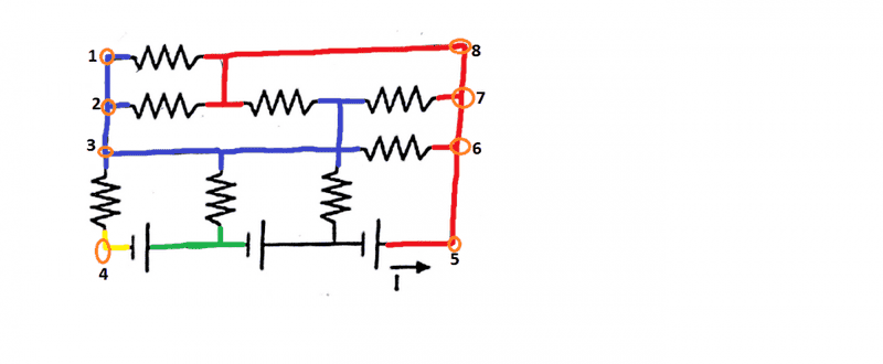

Are 1,2,3,4,5,6,7,8 nodes?If yes ,are 1,2,3 three different (separate)nodes?are 5,6,7,8 four different (separate)nodes?

Everything in blue is part of the same node. It's all made of ideal conductor.
Everything in red is part of the same node. - a node different from the blue node.
No. They are both on the same wire path. Everything with the same color belongs to one node.edit: Ha! SammyS snuck in there while I was otherwise occupied :smile:
No.
In post #11:
The entire blue wire constitutes a single node. Points 1, 2, and 3 are all located on this same node.
Points 5, 6, 7, and 8 are located on the red node.
Point 4 is on the yellow node.

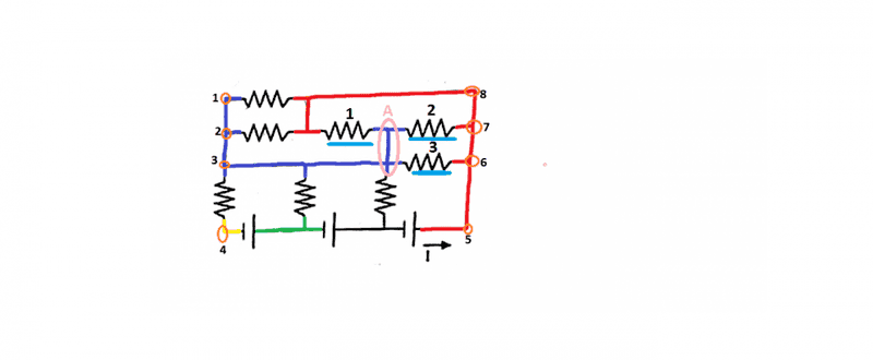

Are component 1,2,3 underlined in blue in series? I think yes because they share a common node as highlighted by pink circle.
No they are not in series. A pair of components in series share a single node exclusively (all alone, with nothing else connected to that node: Just one wire each from two components). The red and blue nodes have a lot of component connections, not two. That section of wire "A" alone that you've identified has four components connected to it!
Besides, those components were identified as being in parallel earlier in the thread. The only case where components can be both in series and in parallel is when there are only two components in the circuit. Then their connections will agree with both definitions:

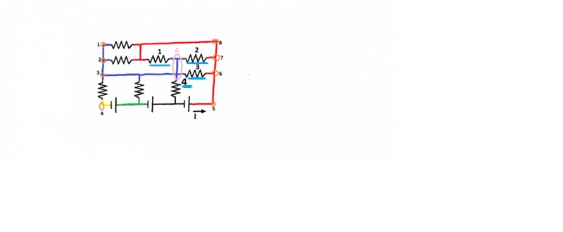

Are component 1,2,3 ,4 underlined in blue in series? I think yes because they share a common node "A"as highlighted by pink circle.
gracy said:
But this implies three components can never be in series.
No it does not. For any number of components in series the connections between the components are exclusive -- only two components connect at any node along the path. There is a single path for current to follow through the string of components. No current can leave the path, and no current can join.
gracy said:
Did you mean if thee are two components in series (that's why you used"pair of component)then othing else connected to that node: Just one wire each from two components)...
Yes.
...and if component are in series then only three components should be connected to that node but A has 4 components connected to it,hence it is wrong!Right?
No, only two components can be connected to any node along a series-connected path. Wire segment "A" has four components connected to it, so none of the components connected there are in series with any of the other components connected there. And, segment "A" is only a small portion of the overall node that is colored in blue. The entire connected path colored in blue is one node, and there are even more components connected to it.
No! There are more than two connections at that node. It is not exclusively shared by exactly two components.
Not even 1 & 2?
gracy said:
Not even 1 & 2?
No. Their connection is not exclusive.
Gracy, there is only one series connection in that entire circuit. That is the resistor and battery in the bottom left corner. They share an exclusive connection.
