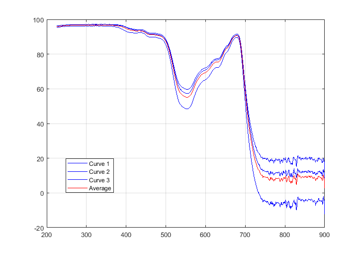

For a project, I am trying to estimate the absorption curve of a certain plant species. Due to the variability within the species, I have taken the average of several measurements.
In the figure below, the blue curves represent 3 separate measurements, and the red curve is their average.
Line graph of reflectance in percent (y-axis, -20 to 100) against wavelength (x-axis, 200 to 900). Three blue curves and an average red curve share a high plateau near 96 at short wavelengths, dip around 500 to 600, rise to about 90 near 680, then fall sharply and split into separate low levels above 700.
I want to shade an area around the resulting red curve as a kind of error bound to represent the observed variability. What quantity do I need to consider here?
Should I simply shade the area from the lowest to the highest recorded value? Or is there some statistical parameter that I could use instead? :confused:
In reality, I have taken much more measurements than the three curves shown above. I would like to know the most appropriate way to represent the magnitude of the error bars.
Any suggestions would be greatly appreciated.
  • Line graph of reflectance in percent (y-axis, -20 to 100) against wavelength (x-axis, 200 to 900). Three blue curves and an average red curve share a high plateau near 96 at short wavelengths, dip around 500 to 600, rise to about 90 near 680, then fall sharply and split into separate low levels above 700.
Hi,
You want to pick up an introductory statistics textbook to introduce yourself to the subject.
Here you have done the averaging point by point using ##<x> = {1\over N}\displaystyle \sum_1^N x_i \ ## where ##<x>## indicates the average value.
The standard deviation estimate tells you where you expect 68% of the measurements to be: in the range ## [<x> - s_N, <x>+s_N]##
This ##s_N## ( aka ##\sigma_N##) divided by ##\sqrt N## tells you the estimated error in the average.
There is one snag: very close to 100% you can't expect symmetric Gaussian distributions; fortunately there your error bars are very small already.
PS are these absorption curves or transmission curves ?

So, I have followed what you said. At each point, I calculated the standard deviation for the 3 values, then for the error I used ##\frac{1}{\sqrt{3}}\sigma_{N=3}##. This is what the result looks like:
Line plot of absorptance against wavelength from 200 to 900, with the mean as a red curve, a shaded red error band and blue curves for the individual data; values are near 95 below 500, dip to about 50-60 around 550, peak near 90 around 680, then fall to about 0-20 beyond 750.
The shaded red area is the values found from ##\frac{1}{\sqrt{3}}\sigma_{N=3}##, the red line is the mean, and the blue curves are the original data. Does this look about right?
Could you explain this a bit more? Did you mean that the error bars would not be symmetric? :confused:
It does.
Actually I was referring to your
for ##N=3## there isn't much statistics.
And there are some remarks to be made:
The statistics expressions apply to independent observations. From the plots it looks like there is some correlation in the tail on the right, where you are somewhat in the noise ?
Yes. A little. The expected distribution is no longer gaussian. Gaussians theoretically extend over all values, but your observations are limited to be ##\le## 100%.
But since you are several ##\sigma_m## away from 100% it's no big deal: the error in the size of the error bars will be greater than the possible asymmetry.

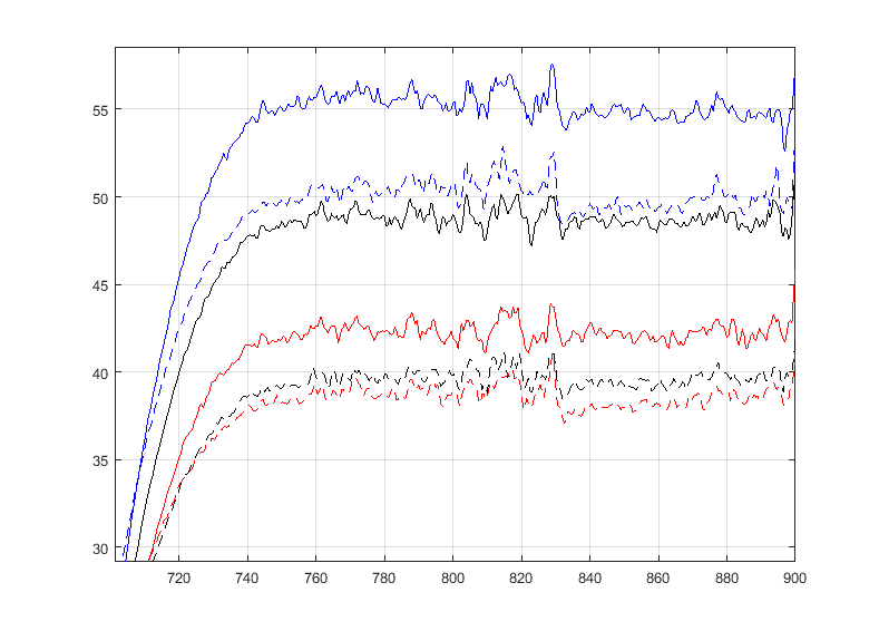

I would be very suspicious about applying standard statistical tests to these curves (to determine error bars, etc.). Here is why: it looks to me as though the three blue curves differ by some systematic factors, not just randomness. Where one curve has a (local) peak, so do the other two; where one decreases. so do the other two. One curve is consistently the highest throughout the whole range; one is consistently lowest, and the third lies between the other two---all the way from one end to the other.
That is not the type of behavior one would expect to see just from random errors. Systematic (non-random) differences would lead to what you see.
Beg to differ a bit. There are systematic errors associated with the individual curves that average out.
I agree that there are systematic errors that are the same for every curve -- and those do not average out (the observations are simply not independent).
Depends on the details: for example,
is the same cuvet used with different samples -- systematic. New cuvet for every sample (probably) -- random errors.
is the same light source used (probably) -- systematic
You know more about the setup than we do, like: are T and R determined simultaneously ? With similar devices ? can't distinguish T and R spectra in the other thread picture but I am surprised they are so close together. How do the correlations sow up there ? In both ? equally divided ?
And I mentioned the visible correlation in the infrared tail that Ray noticed too - but is it very relevant for your results to have accurate error bars there ? (considering that in the far ultraviolet you have no measurement below 220 nm and considerable absorptance there)
The device uses an integrating sphere to measure T and R sequentially. The exact same instrument was used throughout the experiments.
Regarding the correlation in the IR portion: the following is how the individual curves look like prior to subtraction and averaging. Each colour represents a given sample (the dashed lines being T, and the solid lines R).
Line graph of reflectance (solid lines) and transmittance (dashed lines) against wavelength from about 705 to 900 nm, in blue, black and red, with the y-axis from 30 to 57; curves rise steeply below 740 nm then level off.
They clearly look different when examined up close. The correlation is not strong. And we can't decisively say if the small amount of correlation is simply error, or a similar characteristic shared by the samples. I think these small bumps are inconsequential and can be flattened with smoothing — the point is that absorption is lowest in the NIR (how low depends on the sample).

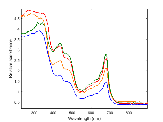

I have two different species. I want to know whether it is possible to distinguish these two plants solely based on their chemical signature.
Of course, the absorption curves of all green plants have the same features (a superposition of the absorption of chlorophyll and water). On average however they seem to be a bit different. But when you add the error bars there is considerable overlap. This is partly why I need the error bars: to see how much overlap there is.
Is there some sort of criteria in statistics that would help you decide if the two sets of data are “distinguishable”?
For example, here is the absorbance for 4 different plant types (based on an average of 3 or 4 measurements):

Referring to your second graph (where you used 4 different plant types), it looks like you might have (significant?) systematic differences in results because the different plant types produce different curves (having the same general shapes but different levels). That is exactly the type of situation that statistical tools such as multivariate regression and/or "analysis of variance (ANOVA)" are designed to deal with. In ANOVA we seek to determine if differences in results for different "treatments" (plant types in your case) are real or just due to random chance events. You can also try to do that in a regression model. In a regression approach you might posit a model of the form
$$\text{Rel. abs.}(i,j) = a_i + f(\lambda_j) + \epsilon_{ij},$$
where ##a_1, a_2, a_3, a_4## are four different numbers corresponding to the four plant types ##i = 1,2,3,4## and the ##\lambda_j, j=1,2, \ldots, n## are the ##n## different wavelengths examined (the same for each plant type). The ##\epsilon_{ij}## are independent mean-zero random errors. Then, the statistical question becomes: after you have estimated the values of the ##a_i## from the data, are they truly 4 (or maybe only 3 or 2) different numbers, or are they 4 numbers that happen to look different because they are just a random sample of size four from some other type of error distribution?
If the ##a_i## are truly different, it would not make much sense to construct an error bar based on them. The way that error bars are interpreted in normal statistical practice is as some type of randomness range estimate. Thus, error bars about each of the four plots separately would be meaningful (assuming you have made enough measurements) because they would be telling you how reliable is the average curve for alfalfa (or oats, or wheat, or barley). Even if you fix attention on one type of crop and one wavelength, there are numerous other uncontrolled and uncontrollabe factors that make the results come out a bit different in each separate experimantal or observational run. That is what we try to treat as a random error, and drawing error bars around the alfalfa curve, or the barley curve, etc., makes good sense. What does not make much sense in some (but perhaps not all circumstances) is to construct some overall type of error bar based on the different crops, because that would essentially be assuming that farmers plant crops at random, tossing a die to decide whether to plant barley or wheat, etc. Of course, from a state-wide or country-wide view that MIGHT make sense, because while each farmer plants crops non-randomly, a large collection of farmers will appear to plant crops randomly. That is, if you were attempting to develop some type of "national" absorption curve, the four crop types would act as random factors that really do contribute to some overall "national" error bar.
Well, at least that is how I see it.

To give some context, my project is about automation distinguishing a specific plant from others in a pasture (e.g. using a hyperspectral camera).
For any species, there will be some degree of natural leaf-to-leaf variability. I am drawing error bars around the curve of each species to reflect this natural variation, rather than just measurement errors (errors of either systematic or accidental nature). By finding the average curves and their error bound, I want to know if it possible to positively determine the species of a given plant based on its spectrum.
So, if the ##a_i## are truly different (for a large enough sample size), can we use that to decide if they are distinguishable?
Also, I am assuming that ##f(\lambda)## is the underlying function. I doubt that it will be the same for all species (since the ingredients can differ slightly).

I'd like to discuss the picture in #22, but "For the small N, these are the profiles for two species" doesn't contain much information. Suppose I see a green line with its ##s_{\scriptscriptstyle N}## band and an orange line with its ##s_{\scriptscriptstyle N}## band. Only range where they don't completely overlap is 380-400 nm and even there the difference is only three sigma. The remainder of the spectrum is useless for distinguishing between O and G.
Suppose (again) that somewhere in the range 380-400 nm the orange species O has 92 % ##\pm## 1 % absorptance and green G has 95 % ##\pm## 1 %.
If you now take one single measurement of an unknown species X and find 90 % ##\pm## 3% there are four hypotheses and each has a certain probability associated with it:
  1. X is G
  2. X is not G
  3. X is O
  4. X is not O
And with the values in this example given, none of them will stick out. 2 will be the biggest, 1 the smallest and 3 > 1.
