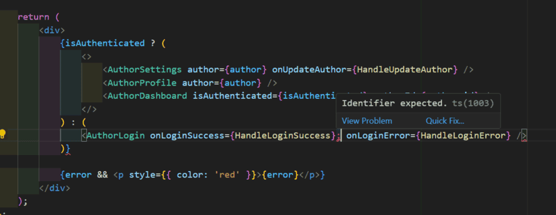

This is the error I get when I try to add a seperator
Also how do I define onLoginSuccess and onLoginError because I thought I already defined it in the Parent Component. So how do I fix it?
Does using a comma as the separator work?

                    <AuthorProfile author={author} />
                    <AuthorDashboard isAuthenticated={isAuthenticated} authorId={author.id} />
                <AuthorLogin onLoginSuccess={handleLoginSuccess} onLoginError={handleLoginError} />
            {error && <p style={{ color: 'red' }}>{error}</p>}
        </div>
If isAuthenticated is false, the block following : should execute. My best guess is that what is needed is a comma before onLoginError in the AuthorLogin line.
If that doesn't work, I don't have any more advice but would advise you to look for some working code that is similar in how it handles errors.
Here's the code, in ParentComponent, where onLoginSuccess and onLoginError are defined.
JavaScript:
<div>
            {isAuthenticated ? (
                    <AuthorSettings author={author} onUpdateAuthor={handleUpdateAuthor} />
        </div>
Adding a comma shows the same error
Yes, neither a comma or anything else belongs there.
@Mark44 this is not plain JavaScript, it is a mix of JavaScript and JSX written for compilation by the React build process.
There are not many of us here on PF that know React, and I can't work out what is wrong on my phone, so this is probably not the best place to seek help: try the official React tutorial https://react.dev/learn/responding-to-events
I've tried but with no luck
Is there anyone you know that could help me with this?
Thanks for your time
