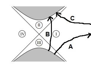

Thanks.I can use Carroll's diagram to discuss what escape velocity means for radially-directed geodesics.
So here is Carroll's diagram of the full Schwarzschild spacetime for an eternal black hole. The regions are:
  • Region I is outside the black hole event horizon.
  • Region II is inside the event horizon. The curved line at the top of Region II is the singularity.
  • Region III is inside the "white hole". The curved line at the bottom is the white hole singularity.
  • Region IV is a second external region. It is ordinary space, like Region I, but it can't be reached from Region I
The two diagonal lines are the event horizons. In terms of Schwarzschild coordinates, which are singular at the event horizon, these lines correspond to ##r = \frac{2GM}{c^2}## and ##t = \pm \infty##.
I've drawn in three types of timelike geodesics:
  • Type A: A test particle emerges in Region III from the white hole in the past,crosses the white hole event horizon into Region I, then escapes to spatial infinity. As described using Schwarzschild coordinates, the test particle seems to arise from the event horizon at time ##t \rightarrow -\infty##, and its radial velocity, ##dr/d\tau## is greater than escape velocity. As ##t## goes to ##+\infty##, the particle escapes to spatial infinity.
  • Type B: A test particle emerges in Region III from the white hole region in the past, crosses the white hole event horizon into Region I, then crosses the black hole event horizon into Region II and finally reaches the black hole singularity. As described using Schwarzschild coordinates, the particle arises from the event horizon at time ##t \rightarrow -\infty## but it has a radial velocity ##dr/d\tau## that is less than escape velocity. It falls back below the event horizon as ##t \rightarrow +\infty##.
  • Type C: A test particle comes in from spatial infinity in Region I and falls through the black hole event horizon into Region II and eventually hits the black hole singularity.
(There are three corresponding geodesic types involving the second external region, IV. There are also orbits, where the geodesic never crosses the event horizon and never goes to spatial infinity. Those are boring. More specifically, they are not radially-directed.)
So for the full Schwarzschild spacetime, the notion of "escape velocity" has the following meaning in different regions:
  • In Region I, a particle with positive radial velocity greater than escape velocity will escape the black hole.
  • In Region II, all particles have negative radial velocity. But those with velocities of magnitude greater than escape velocity came from spatial infinity (assuming that they are following geodesics)
  • In Region III, all particles have positive radial velocity. Those with radial velocities greater than escape velocity will enter Region I and escape to spatial infinity.
