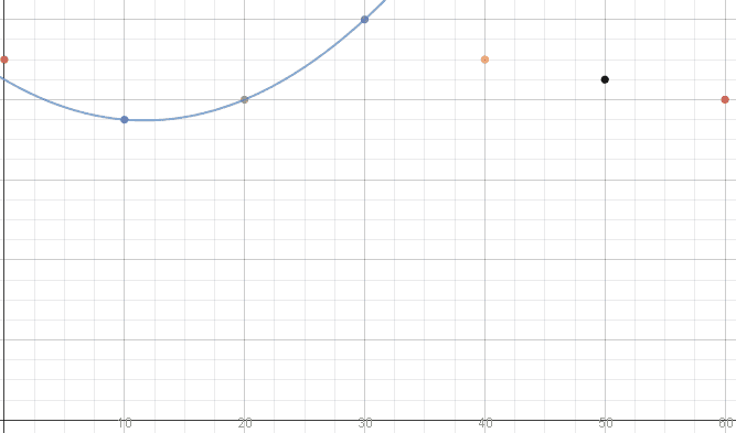

I suspect the method Jameson suggests is what is expected, but since the velocity is only increasing on $10\le t<30$ going by the data points, I might be tempted to find the quadratic passing through the points:
$(10,75),\,(20,80),\,(30,100)$
and then evaluate its derivative at $t=20$.
Another approach would be to simply average the change in velocity from $t=10$ to $t=20$ with the change from $t=20$ to $t=30$. :D
Both methods give the same value...coincidence?

The two methods I suggested also give the same answer as the method you originally posted. I can see why the method you posted and the second method I posted are the same, but I would have to use a little algebra to demonstrate that the quadratic would always produce the same results.
$$\frac{\frac{v(30)-v(20)}{30-20}+\frac{v(20)-v(10)}{20-10}}{2}=\frac{\frac{v(30)-v(20)+v(20)-v(10)}{10}}{2}=\frac{v(30)-v(10)}{20}.$$
Key to this working is that the two points on either side are an equal distance away from the central point, thus making the denominators the same.
Fitting a quadratic would be thus:
\begin{align*}
\ell(x)&=v(10)\frac{t-20}{10-20} \, \frac{t-30}{10-30}+
v(20)\frac{t-10}{20-10} \, \frac{t-30}{20-30}+
v(30)\frac{t-10}{30-10} \, \frac{t-20}{30-20} \\
&=v(10)\frac{(t-20)(t-30)}{200}+v(20)\frac{(t-10)(t-30)}{-100} +v(30)\frac{(t-10)(t-20)}{200}.
\end{align*}
We compute $\ell'(20)$ to obtain:
\begin{align*}
\ell'(20)&=\left[\frac{v(10)}{200}((t-30)+(t-20))-\frac{v(20)}{100}((t-10)+(t-30))+\frac{v(30)}{200}((t-10)+(t-20))\right]_{t=20} \\
&=\left[\frac{v(10)}{200}(2t-50)-\frac{v(20)}{100}(2t-40)+\frac{v(30)}{200}(2t-30)\right]_{t=20} \\
&=\frac{v(10)}{200}(-10)+\frac{v(30)}{200}(10) \\
&=\frac{v(30)-v(10)}{20},
\end{align*}
as before.
For the quadratic, I had in mind beginning with the function:
$$f(x)=ax^2+bx+c$$ where $a\ne0$
And the 3 $x$-values in arithmetic progression:
$$x_1<x_2<x_3$$
And so, we want to demonstrate that:
$$f'\left(x_2\right)=\frac{f\left(x_3\right)-f\left(x_1\right)}{x_3-x_1}$$
$$2ax_2+b=\frac{\left(ax_3^2+bx_3+c\right)-\left(ax_1^2+bx_1+c\right)}{x_3-x_1}$$
$$2ax_2+b=\frac{a\left(x_3^2-x_1^2\right)+b\left(x_3-x_1\right)}{x_3-x_1}$$
$$2ax_2+b=a\left(x_3+x_1\right)+b$$
$$2x_2=x_3+x_1$$
$$x_2-x_1=x_3-x_2$$
Since the three $x$ values are in AP, we know this is true, and so the hypothesis is true.
