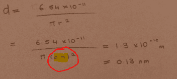

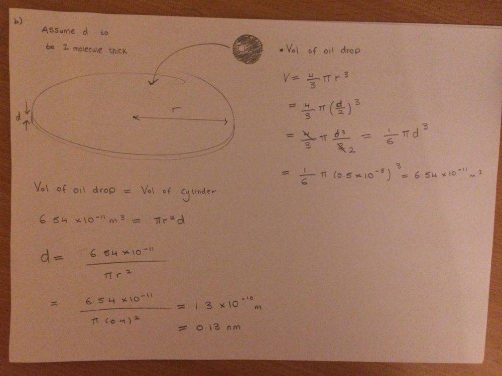

Can anyone help me in what assumptions I can make and how to justify them for when working out diameter of the molecule in part b) of this question? You can see the method that I have used in my workings but how would I explain it in words?
I obtained the diameter to be 0.13 nano metres which seems like a sensible length for a molecules diameter?
Thanks for any help! :)
How did you arrive at the radius of the cylinder being 0.4 (presumably meters)?
I made a silly mistake and used the diameter's length in metres and not the radius length. So it should have read 0.2m instead.
I have changed from 0.4 to 0.2 and get the thickness of d to be 0.521 nano metres now
Yes, that looks better!
Ok so the only assumption that I have made in this problem is that the cylinder thickness is 1 molecule's diameter thick. How do I justify such an assumption?
Perhaps look into surface tension.
