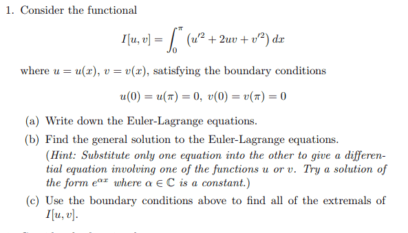

Printed homework problem 1: the functional I[u,v] equals the integral from 0 to pi of (u'^2 + 2uv + v'^2) dx, with boundary conditions u(0)=u(pi)=0, v(0)=v(pi)=0, and parts (a) to (c) asking for the Euler-Lagrange equations, their general solution, and the extremals.
[/B]
$$f_u- \frac{d}{dx} \left(f_{u'} \right) = 0 $$
$$f_v- \frac{d}{dx} \left(f_{v'} \right) = 0 $$
So I calculated the following, if someone could check what I've done it would be greatly appreciated, but I'm not convinced this is right :nb)
$$f=(u')^2+2uv+(v')^2$$
$$f_u=2v$$
$$f_v=2u$$
$$f_{u'}=2u'$$
$$f_{v'}=2v'$$
Subbing these into the Euler-Lagrange equations I got
$$v-u''=0$$
$$u-v''=0$$
Then I subbed ##v=u''## into ##u-v''=0## to get ##u-u''''=0##.
Using ##u=e^{\alpha x}## I got the following expression (not sure if this bit is right)
$$u(x)=Ae^{-x} +Be^{x} +Ce^{ix} +De^{-ix} $$
I'm not sure if I can use the boundary conditions to find the extremals with this? it doesn't look like it would simplify down to a tidy solution?

You can easily check for yourself if this is correct: from you formula for ##u## you can get a formula for ##v## as ##v = u''##. Then you can check if your ##v## gives you ##u = v''##.
Also: get rid of the question marks ("?"). You should be telling us that you are unsure, rather than asking us if you are unsure.
Ahhhh yes I see! I didn't think of doing that,when I subbed my U value into the equations it worked. Thanks for the tip, simple but effective :)
