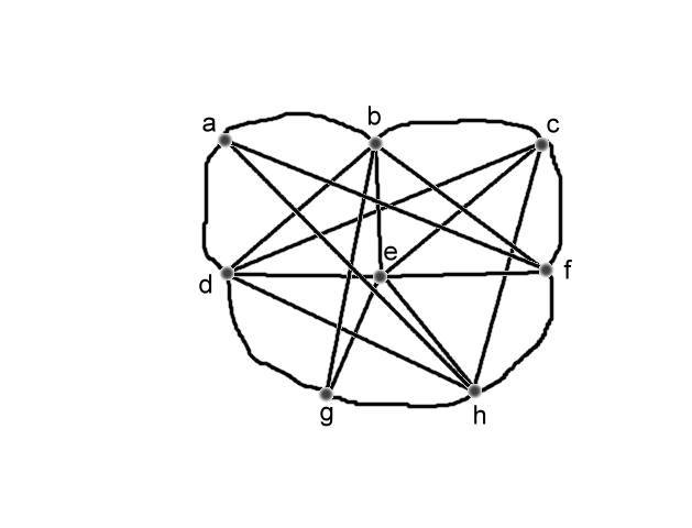

Using Euler's formula and the Handshake Theorem, how can I show that this graph is non-planar? (see graph attached)
My answer:
Euler's formula states that v+f = e+2
Here
v=8
e=21
f=?
so 8+f=21+2
hence f=15 which is not true as there are many more. Hence the graph is non-planar.
Using the Handshake Theorem that states that 2e >= 3f
we get ( 2(21) )/ 3 >= f which gives f <= 14 which again is not true, hence the graph is non-planar.
Am I correct?
Attatchment is still pending approval, but this is just a matter of counting right? I mean you know if it's planar e, v, and f satisfy some simple relations, therefore if they don't satisfy them it's not planar. Have some confidence!
rather than using the two theorems to get results, then say that they are not true, would it not be better to use the fact that they are contradictory?
