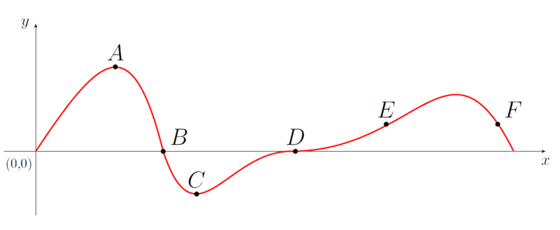

The figure below is the graph of a function ##y = f(x)##. Answer the following questions : ##\\[10pt]##
1. Locate the points at which the ##\text{first derivative}## of ##y## with respect to ##x## is ##\text{non-zero}##.##\\[5pt]##
2. Locate the points at which the ##\text{second derivative}## of ##y## with respect to ##x## is ##\text{non-zero}##. ##\\[10pt]##
1. Given a function ##f(x)##, the first derivative ##f'(x)## is 0 at a point of local extremum (maxima, minima or point of inflexion, also called saddle points). ##\\[5pt]##
2. Given a function ##f(x)##, the second derivative ##f''(x)## is negative or positive at a point of maxima or minima, respectively. At a saddle point, ##f''(x)## is zero also. ##\\[10pt]##

Problem statement :
The function ##y = f(x)## is given above.
Question 1 : Locate the points at which the ##\text{first derivative}## of ##y## with respect to ##x## is ##\text{non-zero}##.##\\[5pt]##
At points of extrema, like A, C and D, the derivative is zero. Hence the derivative is non zero at the remaining points : ##\boxed{B, E, F}##.
Question 2 : Locate the points at which the ##\text{second derivative}## of ##y## with respect to ##x## is ##\text{non-zero}##. ##\\[10pt]##
Now this is the more difficult bit, because no graph of the derivative ##f'(x)## is given. However, we know that at ##A## (a maxima), derivative is negative, hence non-zero##\huge{\checkmark}##. At ##C## (a minima), derivative is positive, hence non-zero##\huge{\checkmark}##. At saddle point ##D##, second derivative (and first derivative) is zero. It gets a bit tricky at points ##B, E, F##. At ##B##, ##f'(x)## is negative and (looks to) remain the same before and after. So if we assume ##f'(B)## to be locally constant, ##f''(B)## must be zero. ##\huge{\times}## The same can be said for points ##E,F##; at all these points, the function ##f(x)## is either monotically increasing or decreasing implying that the derivative is constant and that the second derivative is zero. ##\huge{\times}##
So my answer is, at points ##\boxed{A,C}## are the second derivatives of the function non-zero.
Are my answers correct? A hint would be welcome.
For a local extremum, the second derivative will tell you whether or not it is a max or min (or if it is zero - it could be either or a saddle point). This does not mean that it is zero away from all minima. The second derivative is zero if the graph does not curve at the given point.
Points where the second derivative is zero can be points where the concavity of the function change ...

I agree with your answer to part 1 but disagree with your answer to part 2. Your descriptions of the first and second derivatives are not very good. There is more to say than how they behave at extreme points. I would say that the first derivative is the slope and the second derivative is the curvature. Try using those descriptions to answer the questions.
@Orodruin - Yes, once I have been able to ascertain that it is an extremum, by virtue of the vanishing of the first derivative, the second derivative can tell me if it is a maximum or minimum. But you go on to add :
The second derivative is a bit hard to visualise because it's a slope of a slope. But yes, it tells us as to how a function curves. I can understand how given a function ##y = x^2##, the second derivative is positive everywhere. That is because even though the first derivative (##2x##) is negative below zero and positive above zero, it is everywhere increasing. Also this graph is concave, so perhaps a positive second derivative has to do with concavitity and vice versa.
Red curve on x-y axes starting at the origin, with labelled points A (local maximum), B (crossing the x-axis), C (local minimum), D (flat point on the axis), E and F on the rising and falling part at the right.
Yes, my first answer about only the derivative is correct, as I have checked from the website later. Let me put the graph here again. For the second question, the book says that point ##F## has second derivative non-zero, along with points ##A,C## (which I got). Far as I can see, at ##F##, the slope is constant around it, much like at point ##B##, hence the second derivative has to be zero. Or, taking your definition, the graph does not curve at ##F##.
Please let me know if am wrong when you have the time.

I think that if you look closely, you would see that there is some curvature at F. It is not exactly straight there.

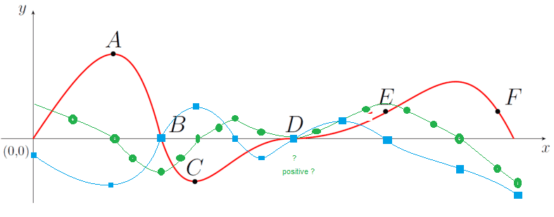

Make a graph of the first derivative. Do this first.
I'm no mathematician, but we used to do curve sketching. You just mark some obvious points then join them up in approx the right sort of way.
Here green is 1st deriv, then blue is 2nd deriv obtained as 1st deriv of green sketch.
This is a quick first attempt in Paint, so not very accurate, but the zeros are preetty obvious.
At D, I can't see any reason why green has to be zero, but it's a minimum, so blue is zero.
Similarly at B, I can't see any reason why the inflexion between A and C of the red line has to be at B (the zero of red), so the blue zero (and green minimum) probably should be slightly away from B. (This is not shown, because I didn't realize this at first.)
The zero and max at E are not uncertain, because the only reason to put E there is to mark the max slope.

I do not want to see both your first (green) and second derivatives (blue) in the graph just yet but would rather try and sketch them myself. This was suggested to me in post# 14 above by @MidgetDwarf. I am excited about this because I have never done it myself before!
Thank you for your time. I will return to your sketch at places where I struggle.
Apologies. I hadn't remembered this was a HW Q.
I've deleted it for now.

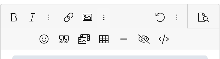

I see some people can hide things with "Spoiler Alert" but I don't know how to do that.
In the rows of symbols above the editing field (click the three dots if all do not appear), click the eye with the diagonal line across.

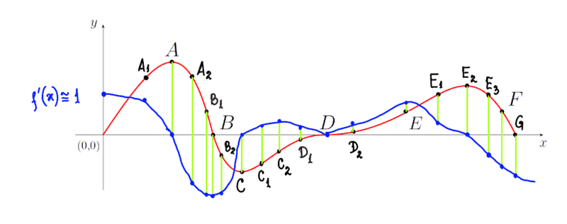

I have never done this but willing to try. This has been done in post#15 above by @Merlin3189 but I would only refer to it if I struggle.
Problem : Let me start by putting the image first, to the right. (I hope it's big enough to see).
Question : I would answer the original questions later (see my post# 1 above). For now the question is : ##\text{Given the graph of the function}\; f(x)\;, \text{draw the graph of its derivative}\;f'(x)\; \text{over the same domain}##.
Attempt : I would like to take this in intervals, if you don't mind. Of course it shows I am tentative. I find the derivative(s) by deciding on the "amount" of the slope the tangent has at the point in question. For local maxima and minima I am helped by the fact that the derivative is vanishing. For near straight paths, the derivative remains almost constant.
Red curve f(x) with points A to G marked, and a blue curve drawn as its derivative f'(x) over the same domain, with green vertical lines linking points. Labeled y and x axes, origin (0,0), and f'(π) ≅ 1 written in blue.
Please let me know how well have I done, when you can. Thanks for your time and patience.

@MidgetDwarf - If the moment is right given by drawing of ##f'(x)## above for the given function, I would like to know what your second hint was.

That looks good to me. I think you can see how difficult this would be to go on to the second derivative. You have to be accurate about the slope of the derivative curve you drew.
