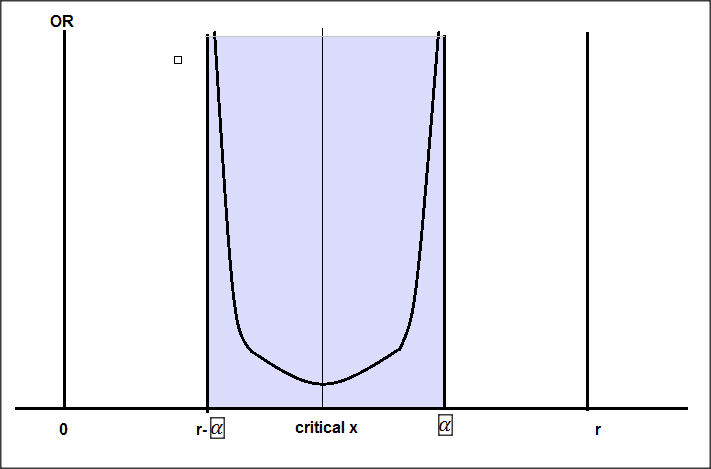

Here are conditions I use to define my problem:
1) I use cumulative distribution of 2 logistic functions g1(x) and g2(x) with g2 is translated to the right of the g1(x) on x-axis.
2) I make a transformation to eliminate both tails of the function which will not have a significant contribution to the result, so my transformation is:
f(x) = g(x) - g(α) / g(1-α) - g(α).
where g(α) can be chosen to be equal to 0.05 and g(1-α)= 0.95.
3) g2(x) is translated with amount r to the right side of g1(x).
The aim of the study is to determine the best odd ratio (OR) between g1(x)/1-g1(x) and g2(x)/1-g2(x). In other words, I am looking for minimizing this ratio by taking the first derivatives and making it equal to zero and then calculate x.
to make the matter more simpler, I assumed that the scale parameters of both g1(x) and g2(x) are equal to each other.
surprisingly, after calculation I got x=-∝ which minimizing the ratio against the intuition that x should equal to 1/2 r. Please look at the attached diagram where the area with pink shade represents the interval where x should lie. On both boundaries of this area, OR will be ∝ and OR should come to a minimum at the required x. I made an initial transformation y=e-x and n=yk where k is the scale parameter which I put it to be the same in 2 functions. So I got n=0 (trivial solution) which means y=0 only at x=-∝. So, how come the calculation came opposite to the right intuition that x should = 1/2 r.[/SUB][/SUB][/SUB][/SUB][/SUB][/SUB][/SUB][/SUB]

The functions get very close to 0 and 1 exponentially, I'm not surprised to see their ratio be optimized "at infinity".
This is correct for the original function g(x) but not for the transformed function f(x). Because f(x) is exactly equal to 0 at x= α and f(x) is exactly equal to 1 at x=-α,,, {sorry for the typing mistake in the original post, the transformation should be f(x) = g(x) - g(α) / g(-α) - g(α)}. where α corresponds to the value of x where the function has the value of 0.05 and -α corresponds to te value of x where the function has 0.95
Now at the interval x∈{r-α , α} the odd ratio defined as f2(x)/1-f2(x) / f1(x)/1-f1(x) approach infinity at both boundaries, namely, at x= α and x= r-α. But converge to a minimum at x=xc which I call it critical x. And my project is to find xc which I found it equals to -∝ which means there is something wrong in my calculation.
Then your ratio gets even more extreme until it gets undefined - and you'll have to consider at least 5 different ranges individually. Did you do that?
It would help to see what you did in more detail. And what exactly do you want to find, and why?

But this is not going to match the OR (odd ratio) curve which it should have a minimum in the range {r-α, α}.
I expect the first derivatives of OR to have only one root at critical x, xc not five roots.
My formula for minimizing OR is ∂OR/∂x = (∂OR/∂n)(∂n/∂x) + (∂OR/∂m)(∂m/∂x)
where, n= e-k2x, m= e-k1x
∂n/∂x= -k2 n, ∂m/∂x= -k1 m.
This would reduce the equation I got in the post#10 into; A mn2 + B(1-k2/k1)mn + Cm + D(k2/k1) m2n + fF n=0
  • Plot of OR against x with a U-shaped curve between marked points r-α and α, its minimum at critical x; the curve rises steeply toward both ends and a vertical line marks r.
